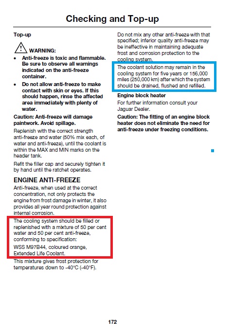

There's three things to consider with coolant:
1. specification - WSS M97B44 Extended Life (usually coloured orange)
2. concentration - 50% Coolant : 50% Water
3. change interval - 5 years OR 150K miles
There's nothing magical about coolant in a Jaguar bottle - it's the specification that's important and not the brand. Plenty of aftermarket sources for coolant to the right specification.
I'd be concerned if there's no discernible colour to the coolant in your vehicle that the PO has been topping up with plain water. Time for a drain, flush and refill so you know exactly what's in there.
