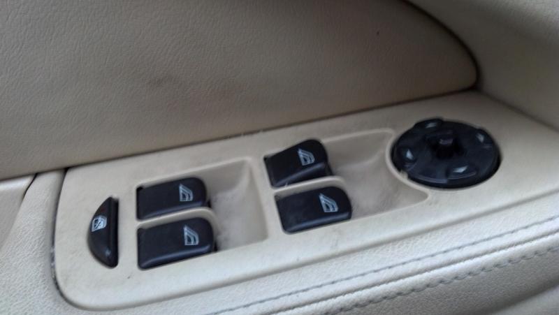

Sup folks, i have a couple of issues with my 03 x-type that i wanted to run by you guys before getting ripped off at the dealership. I was trying to lower my driver window and saw that it was non-responsive. The switch had no pressure on it and it was just flopping up and down, just wanted to know if there is a method of opening the panel to fix it. Also the side skirt of my car is about to fall off, my friend stood on it like an idiot and now i can see on the inside the screws are stripped off. To be honest im not even too sure whats holding it up but i was told epoxy glue would do the trick. I am currently saving money to move to nyc where i'm not going to do too much driving so i dont want to spend too much on repairs, if you guys could just give me your input on the best method to fix these issues would be much appreciated.
