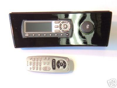

Can anyone post up some pics of what the dealer installed Sirius Radio and the Audio Connectivity Module actually look like?

this is what the acm looks like installed
the sirius gets mounted in place of your ashtray. it could be removed and installed into another car i would guess, but you may need to buy some sort of an fm transmitter (wired or wireless, wired sounds better).
another option is to buy your own and install it. i personally have a starmate replay and there are single din (read: half the size of the radio, perfect for the ashtray with a bit of trimming) mounts available. it looks almost identical to the one the jag uses.i actually have a spare one that has a slight cut in it if you are interested. you will have to dremmel out some of the ashtray (inside) to make it fit, or you could buy the spare ashtray i already modified to fit. hell, i even have both antenna leads for the jag to convert it to be able to use a sirius fm modulator that i will not be using now.i was going to do it to my X, but as it is my 'fun' car and not the daily driver i installed it in my work car. the sirius fm modulator sounds almost as good as the ACM does, with only the slightest bit of white noise when the radio is turned up allthe way. if interested let me know.

There is no ashtray door, it is replaced with the radio and a sort of cover thing that replaces the ashtray cover.
