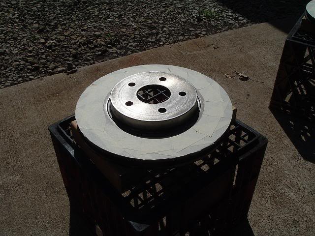

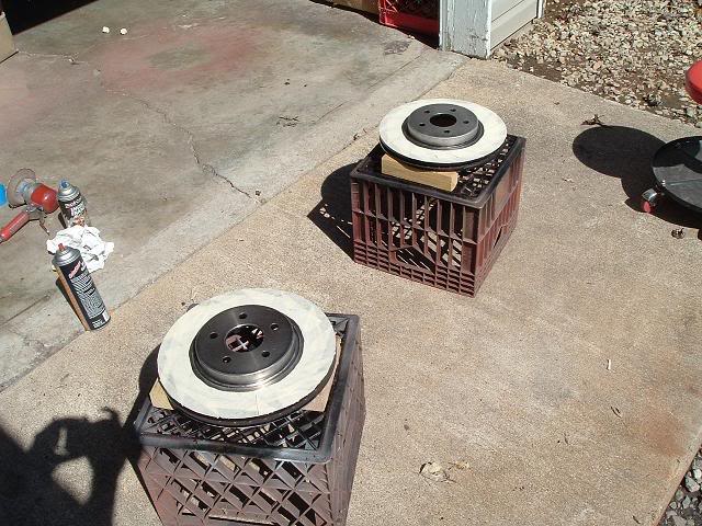

Prepping the rotors.
I sanded all the black paint that came on them and cleaned them thouroughly. Then I taped off the actual braking surface, and painted them front and back (back not pictured) and down into the vents on the edges.

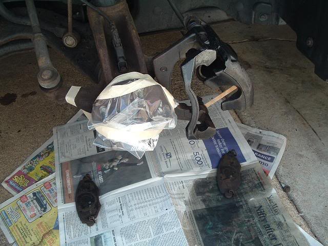

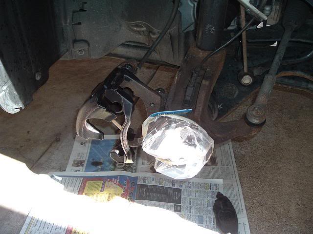

Here I started wirebrushing the calipers to get some of the loose old paint off. They didn't necessairly look *bad* before, but were starting to chip.. and that would look too good with what's being delivered tomorrow..
Note the popsickle sticks used to rotate and prop the calipers away from the caliper bracket to allow enough room to paint. I did it this way so I wouldn't have to remove the calipers from the car, and in turn having to bleed the brakes.

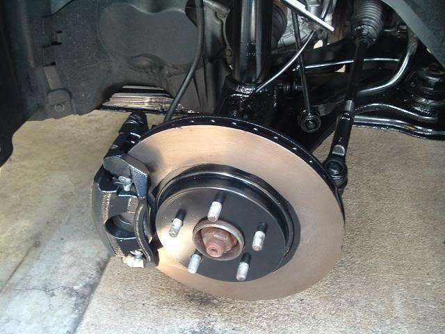

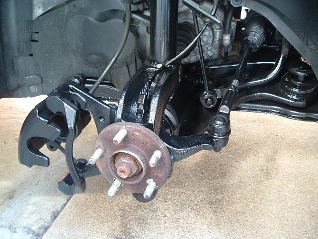

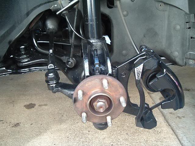

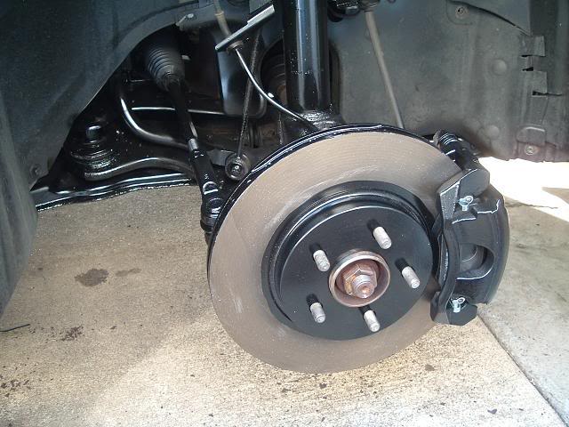

Painted. I didn't paint the hub itself because I've been having trouble with getting the wheels to not seize to the hubs, so I left them unpainted, cleaned them, and applied a thin coat of grease to help prevent the problem.

I think it looks a MILLION times better, especially the tierod end, sway bar, and shock.
EDIT: Something else I wanted to note..
If you look closely, you'll see I didn't leave a clean, sharp paint edge on the face of the rotors, coming away from the top hat section. I did this so after a couple drives the pads would remove the paint where it needed to be done, leaving a sharp edge, and no ring of rust that occurs when enough of the rotors isn't painted.
