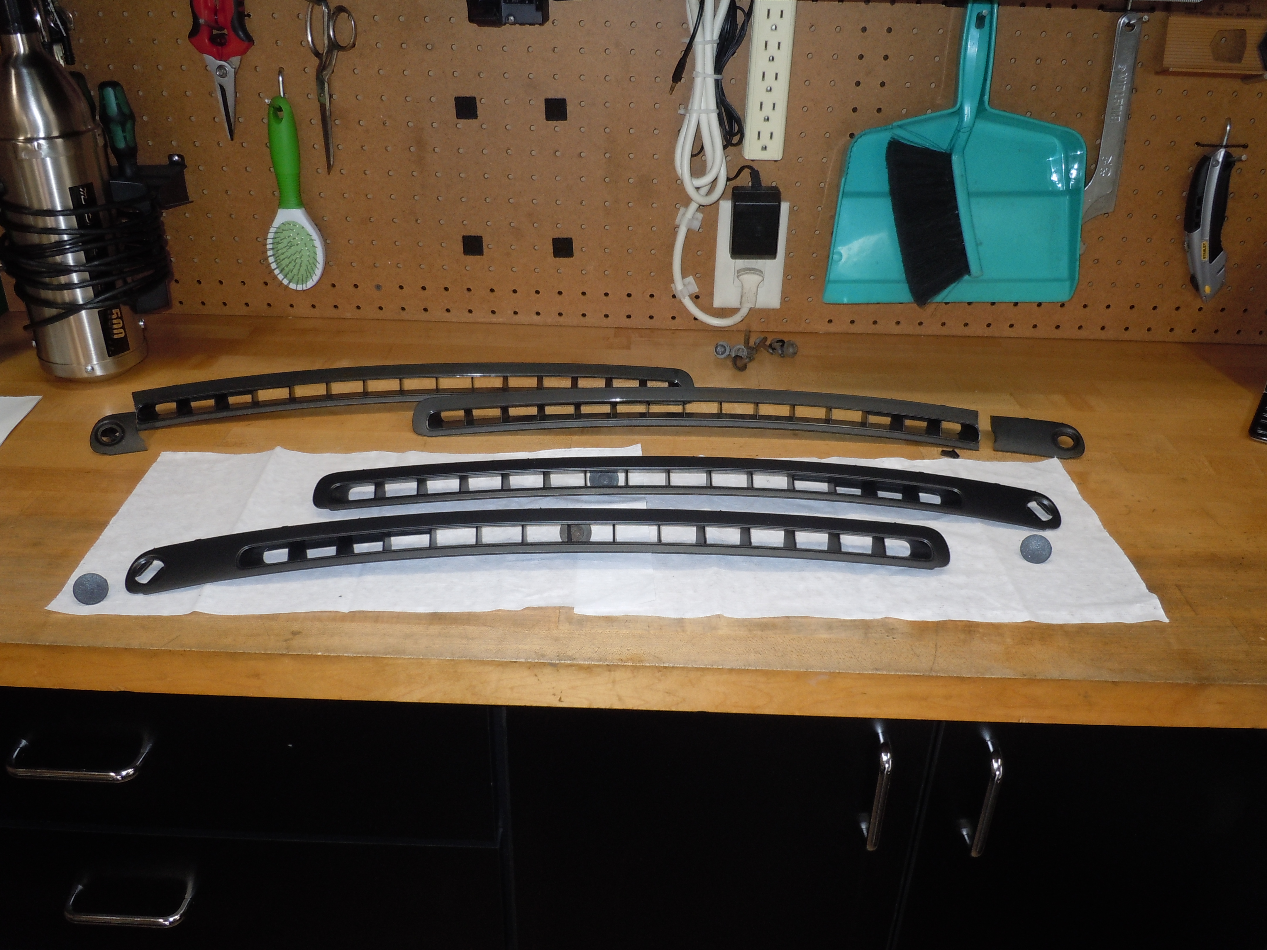

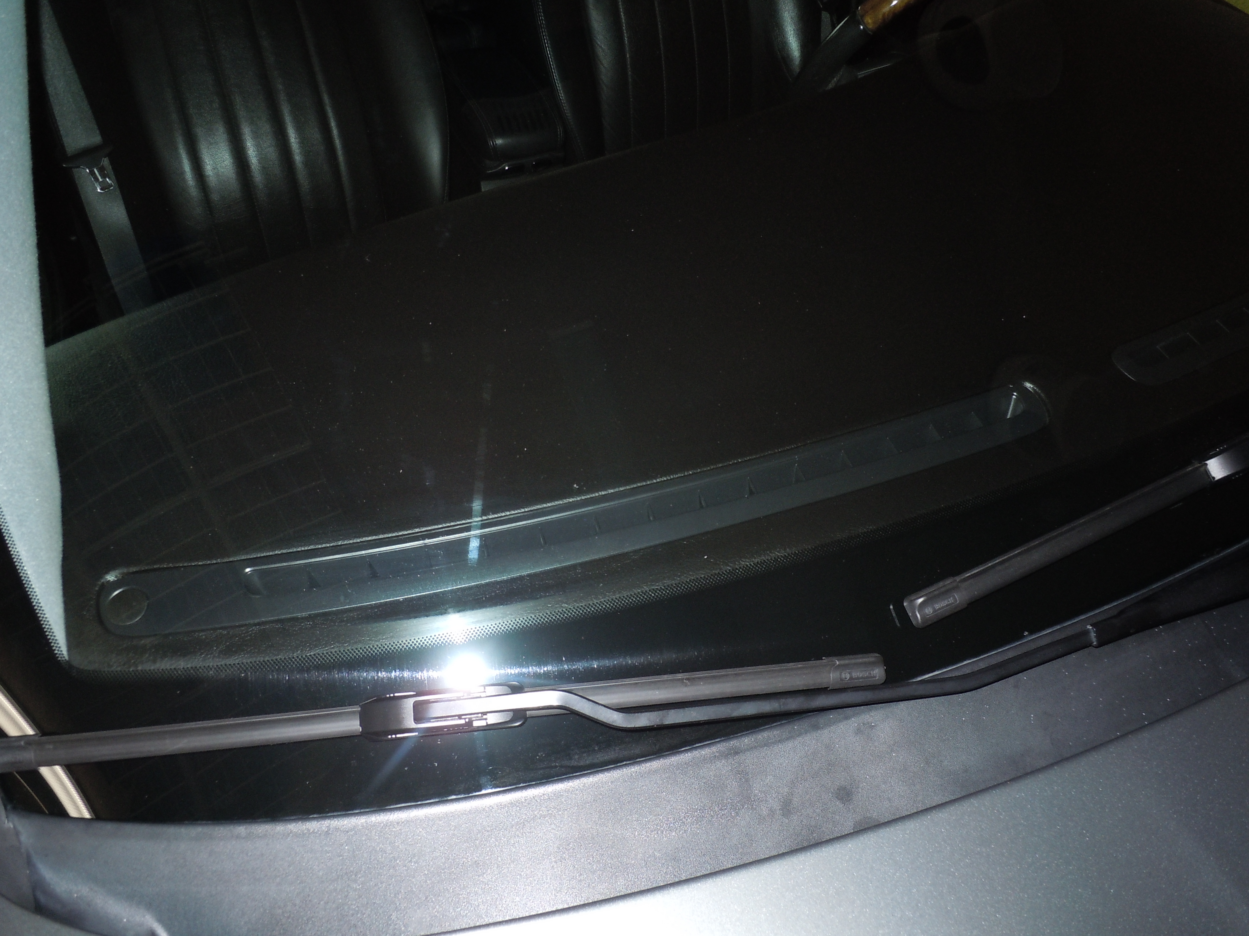

I've read that the defroster (demister) vents are a common failure item, probably from repeated heat cycles and sun exposure. Sure enough, I looked at mine and both were broken. This is a very simple quick fix.
I have the Warm Charcoal interior, hence the LEG suffix. Parts I needed:
1 C2S43948LEG Grille
1 C2S43949LEG Grille
2 C2S44682LEG Plug-Blanking (order these as the old ones will probably break when removed)
Steps:
1. Use trim tool or thin screwdriver to pop out the old blanking plugs. Remove old grill and clean out vent recess. I treated my dash to a coat of vinyl protectant.
2. Insert new grill (there's a tab on inboard end) and lock down with new blanking plug.
3. Clean paw prints off inside of windshield and you're done. Enjoy!

The small hole on the outboard end of the grille is for the securing fastener (Jaguar calls it a blanking plug). As I mentioned the old ones will probably break when removed.

Daddy, as I recall there's two fingers on each blanking plug that are supposed to snap into place, securing the vent grill. Have you looked at your plugs? One or both of the fingers may have broken off. Also your vent grills may be warped, preventing them from staying put. Miles really don't mean much - it's age of the plastic methinks. I replaced both grills and blanking plugs and all's well. As I recall your interior color is same as my car - Warm Charcoal, suffix LEG.
