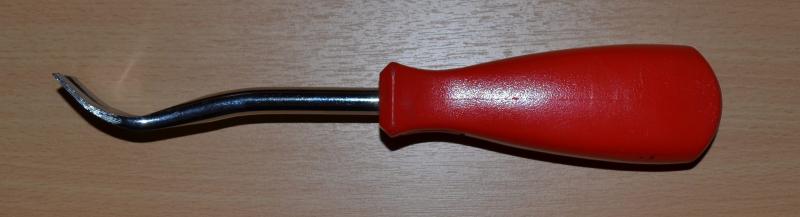

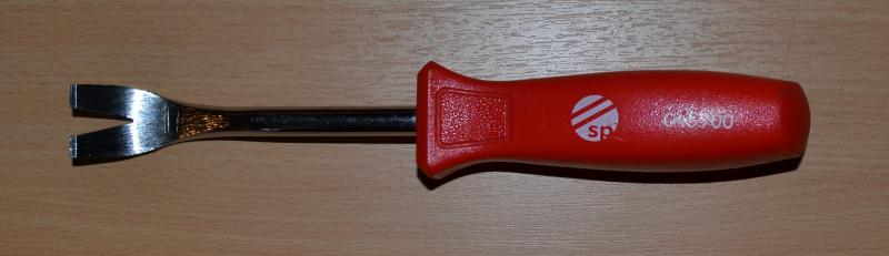

Have you not got a door trim removal tool?
I rarely break a clip when using this.
Attached Thumbnails Door Card Clips-dsc_0075.jpg   Door Card Clips-dsc_0076.jpg

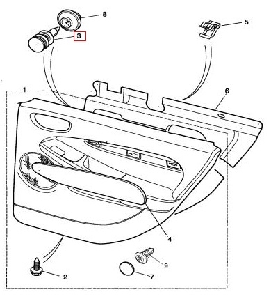

Let's try to get you a little more progress with this. Here's the Parts Manual drawing so you can see what is required:
There's part number changes dependent on VIN (for Item 3) PushIn Fastener and colour for (Item 7) Screw Cover.
Cambo has already listed part numbers of the four available colours of PushIn Fastener (Item 3) in his post #3 above. The part number you need for these depends on your VIN. The reason for the different ones being available is they are different lengths.
With your VIN, I can lookup the correct part numbers for Item 3 for you but your are going to have to take the panel off to count the number required unless someone posts with this information.

For VIN Range up to D24745:
PushIn Faster (item 3) is the Green one = Part Number C2S13493
This goes into Insert (item 8) of which there are two types available. Again they are colour coded:
White = Part Number C2S20167
Black = Part Number C2S20168
There's no VIN given against these but it should simply be a matter of checking what it currently fitted.
