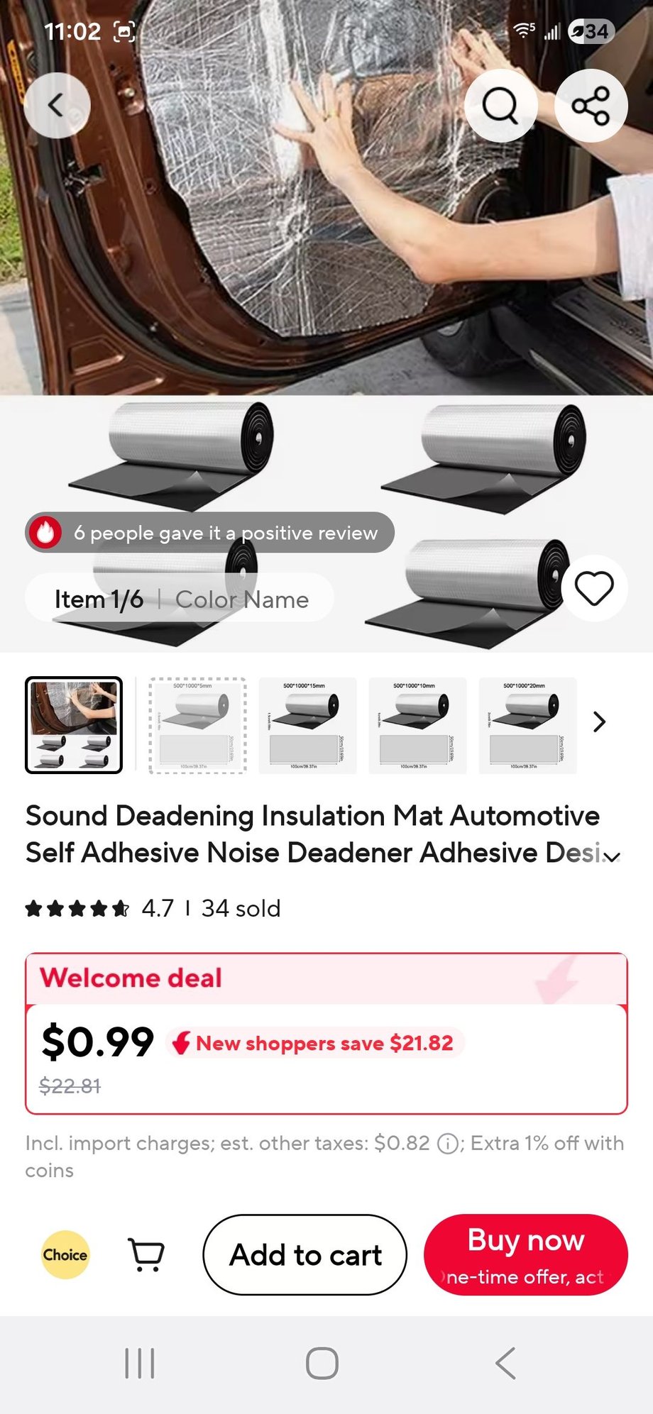

As for the "cover material" try some sound and temperature deadening rolls like this =
