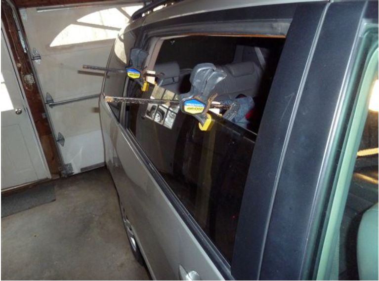

greenestate: A trick to replace a window regulator........
Raise the window mostly to the top so you can access the old regulator. Clamp two short pieces of wood inside the window with the bottom of the wood resting on the window ledge inside the door. The wood supports the window so it won't fall after you remove the old regulator, and makes it easy to install the new regulator.
I can't take credit for this trick as it, along with the attached picture, are from a Toyota Sienna forum.

Thanks guys... I'll be using the wood and clamps trick for sure .
