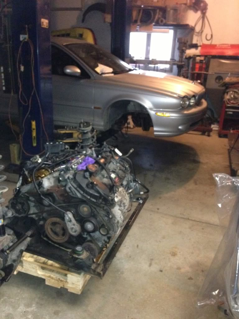

ummm… so…. I'll fill in a lot more later about what (and how) we're doing in our X-Type engine replacement. We need some immediate help however so here's my question.
We've dropped the subframe/engine/trans out of the car (actually we RAISED the car while the subframe sat on a palette). We had NOT disconnected the driveshaft. We'd only taken the torx bolts out on the front end.
Now we've taken out the rear torx bolts and the center support bearing but for the life of us we cannot figure out HOW to take the drive shaft off the car.
What are we missing?

HI (mark again working with Petah)
SLEEP on it (and let WD-40 do some work) !
A good smack with a mallet AT THE BACK of the shaft and it dropped ! Once I saw what the joints looked like - I knew I just wasn't hitting to get off before.
