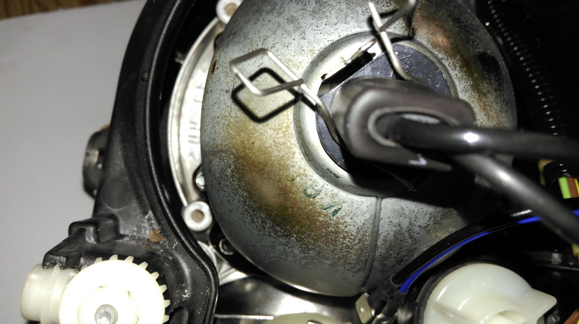

Thanks for the links to those websites. Based on what I read, the MaxLux doesn't even show up in the top 10 - very disappointing. That said, the physical design of the H1 HID bulb seems to be pretty universal across all brands, which still leaves me with the same problem; making it work with the existing clips. The attached picture shows it best:

I had hoped that someone could help me with suggestions for fitting the replacement HID bulb into the existing reflector opening. Notwithstanding the manufacturer's claim that it fits an X-Type, the bulb base is too big for the retaining clips. I'm not inept (used to own a foreign car repair shop), but I could not find a way to keep the bulb in place with the retaining clips, even with bending them. Has anyone used an HID kit where the bulb is truly a direct replacement? Also, I've seen adapters online to fit HID bulbs to specific model cars and am wondering if that is the solution to this problem.

May i suggest a crude but effective work around for this? I was faced with the same issues on my old Jag, i simply smeared a thin layer of silicone sealant the stuff that smells like venegar, around the lamp base and let it set. Strong enough to hold in place but weak enough to remove the lamp with a strong pull

Thanks, great idea.
