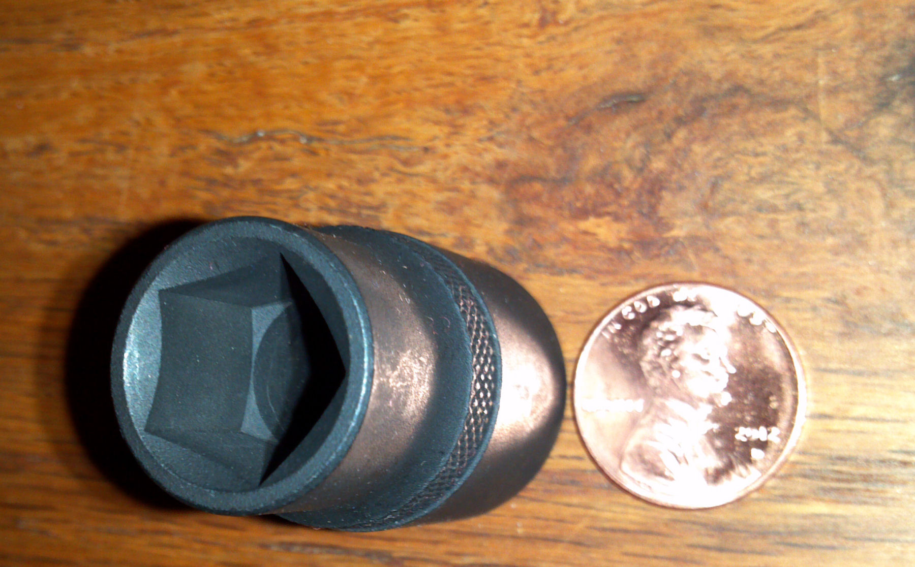

One of the other members talked awhile back about how to fix a sticking e-brake lever. Well, I have been suffering from these and I decided to take it one step further and dig into what is going on. When doing what I am going to say here, the only special tools that you are going to need is:
1) piston retractor tool/block ($10 or so at your local parts store)
2) a 14mm pentasocket (special socket that only has 5 points to it, can be had off the internet for around $20 unless you live in the UK, then you can probably get it for around $5 USD)

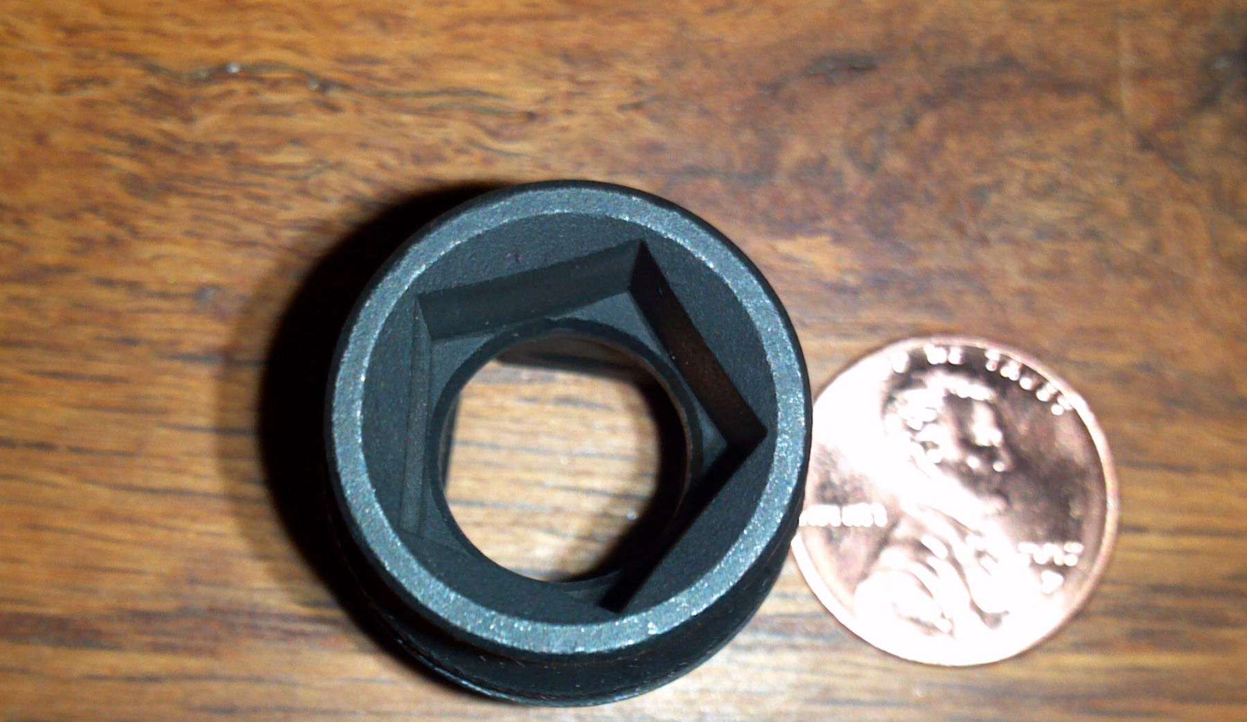

Dennis, if you look around, you can find them. Some places call them pentasockets, others call them "brake sockets". Either way, you need a 14mm version of it. Here are a few links that I found to them:
Laser Tools 4149 Other Brake Servicing Pentagon Brake Socket 14mm Tool Garage | eBay WARNING, beware of the shipping on this one, socket is cheap, shipping, holy @#$%!!!!!!!
US Pro Pentagon Brake Adjustment Socket Bit Set AT199 | eBay This is more like it.
3 Piece 5 Sided Pentagon Socket Set for Girdling Bendix Brakes 1893ERA | eBay Not the cheapest, but not too bad either.

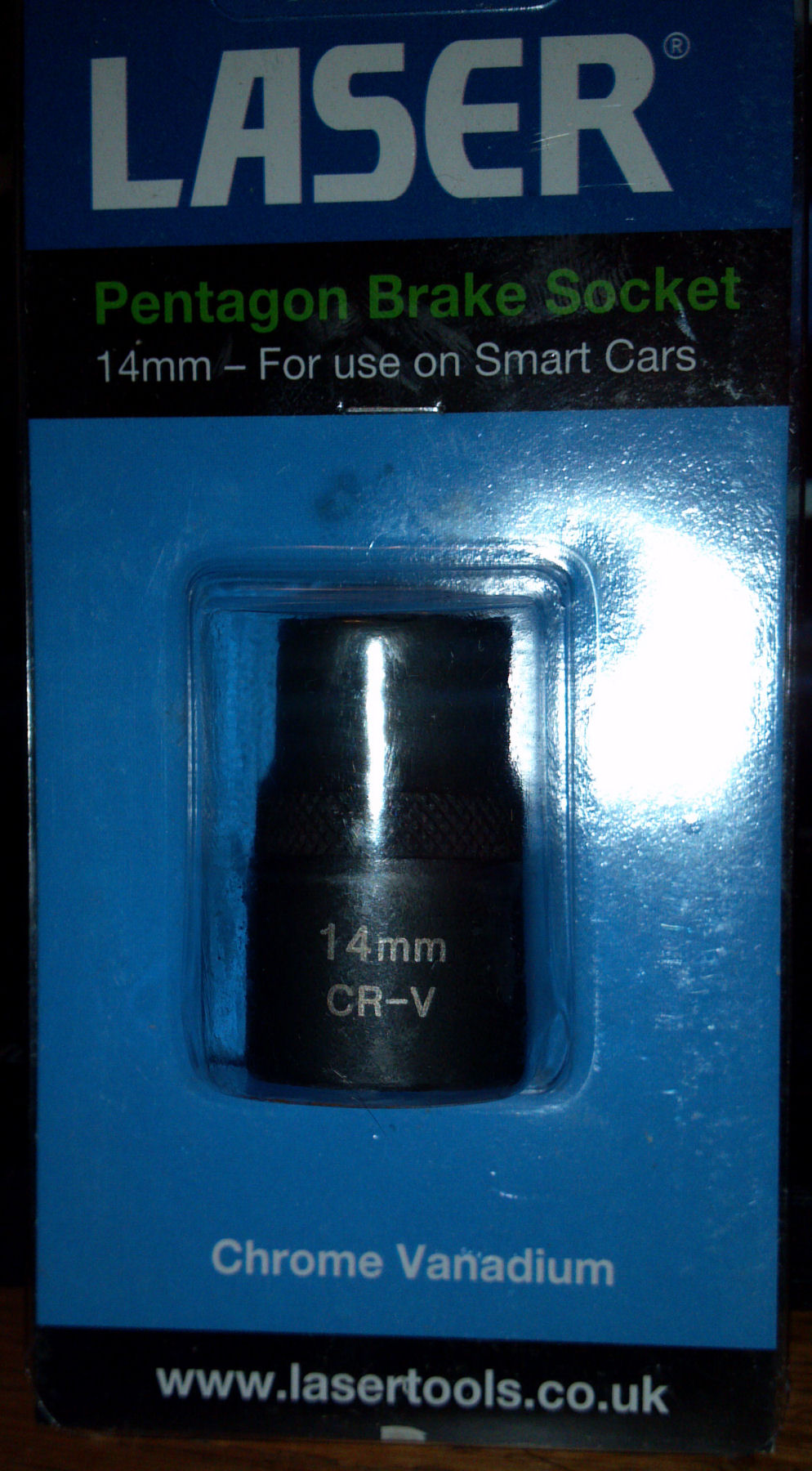

I ordered one through Amazon, $17.50 inc. shipping from the UK
It'll take a month to arrive, but a fair price
Ordered 2 Feb 13 through Amazon, arrived via USPS 19 Feb 13
Socket: $10.21
Shipping: $7.21
1/2" drive, thin wall at the socket end so it shouldn't pose any problem getting down into the recessed area
