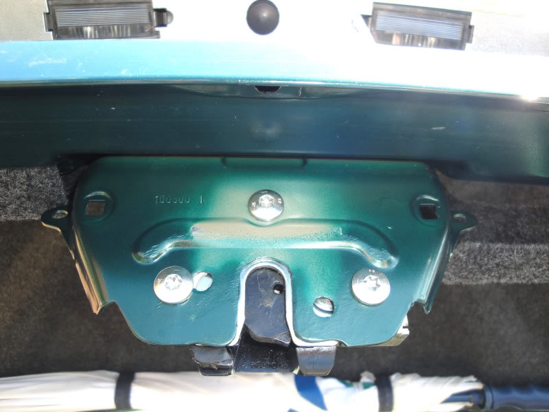

Use very light pressure on the screwdriver as these screws will strip even when undoing them! If all else fails, they can just be pulled out and replaced with new. Then remove the locking motor assembly held on with these three torx screws, remembering to mark the position of the lock to allow it to be replaced in exactly the same position later.

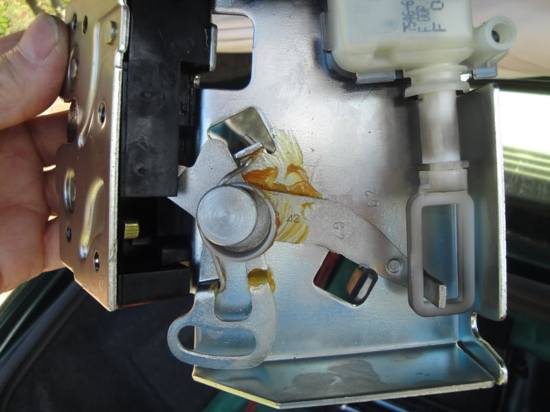

You should now see some of the internals as shown here

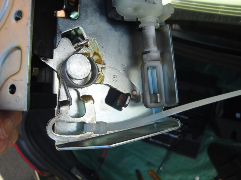

Attach a 10 inch long tie wrap as shown here to the arm (used in the US spec to allow the internal operating pull to be attached?) Anyway, it’s just what we need for this project.
Now feed the end of this tie wrap through this hole and replace the lock assembly.
