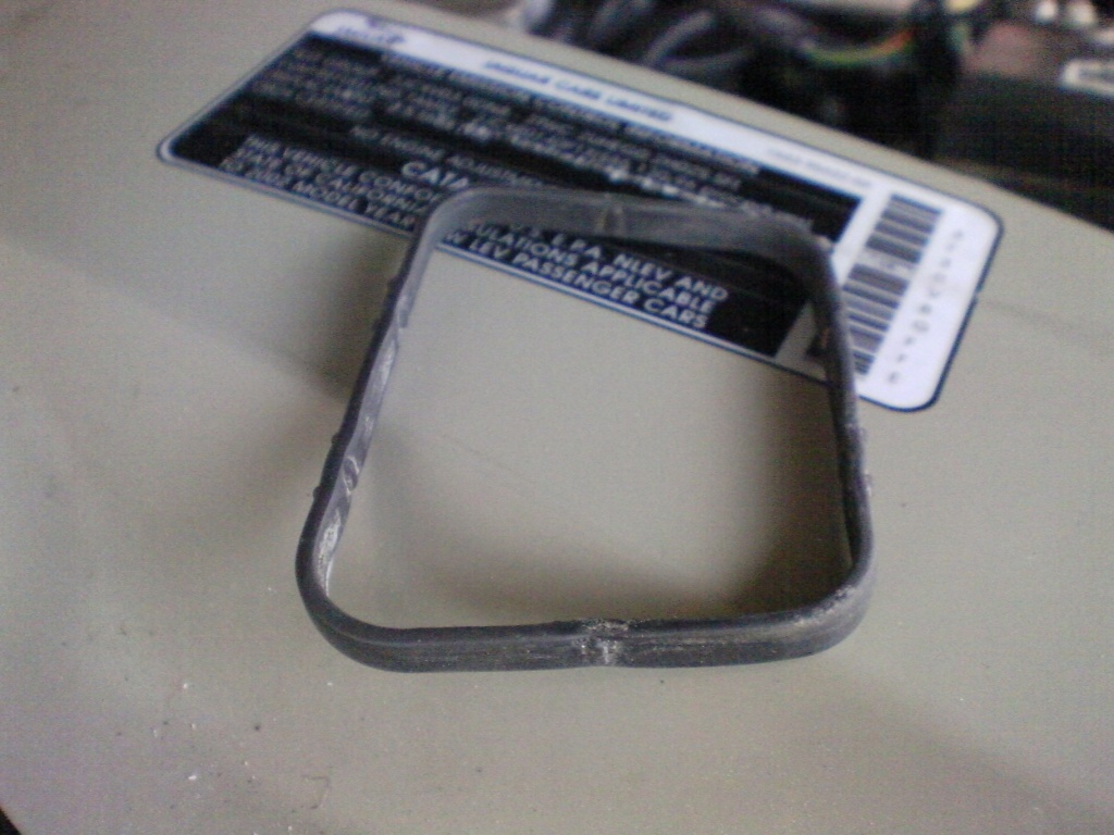

So the radiator is an easy fix, just add money. But the drips at the thermostat housing have me more concerned. With the rad out of the way, its an easy reach to the thermo-housing. There was some corrosion at the "O-ring" (let's call it, not really an "O", but for ease of discussion...). I polished the metal side with some crocus cloth and scotchbrite, and it looks pretty smooth, but I am not 100% sure a new O-ring is going to be enough to seal it.
Has anyone used any gasket compounds on the thermostat housing to water pump housing joint with good luck and if so what kind did you use?

One thing to remember when dealing with these plastic parts is: don't over-torque it!
Check the torque spec for the bolts. The housings easily flex and can cause an
otherwise good part to leak.

That is true, and thanks for the reminder. Forturnately metal inserts in the stud holes in the plastic housing help prevent a lot of oop's, but they aren't failsafe.

Still wondering about gasket compound on the thermostat housing to water pump housing? I don't want to add it if I don't have to, but I sure don't want this to leak again.
