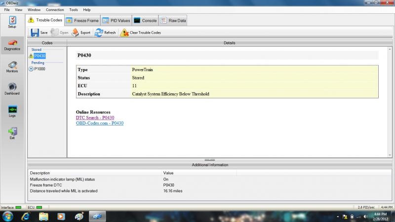

Hello there guys, after error codes P0171 & P0174 fixed by replacing the lower intake gaskets.. now I get P0430. Is this car ever going to be happy?
I have done everything, from plugs to o2 sensor, O rings, intake gaskets, air & gas filter.Why error codes come one at a time..you fix one and there comes a new one..
I would like your opinion and help again.
Thank you all..

OBD Code P0430refers to
Basically this means that the oxygen sensor downstream of the catalytic converter on bank 2 is detecting that the converter is not working as efficiently as it should be (according to specs). It is part of the vehicle emissions system.

Had the smoke test done yesterday to check for vacuum leak. Did find one between the manifold and throttle body, so gasket was replaced. Car does seem to idle better this morning on start-up, but fault code P0430 came back on within a few drive cycles. Scanner shows O2 sensor 2 in Bank 2 fluctuating between .15 to .75 versus .15 to .20 in Bank 1. Also, sensors appear to change readings fairly quickly. Does this mean that catalytic converter is really faulty? If so, I may have to resort to the spacer method for now at least until I have my smog inspection in July. Or I can either keep clearing the fault code or just ignore it completely, especially if it's not affecting the drivability or fuel consumption.
