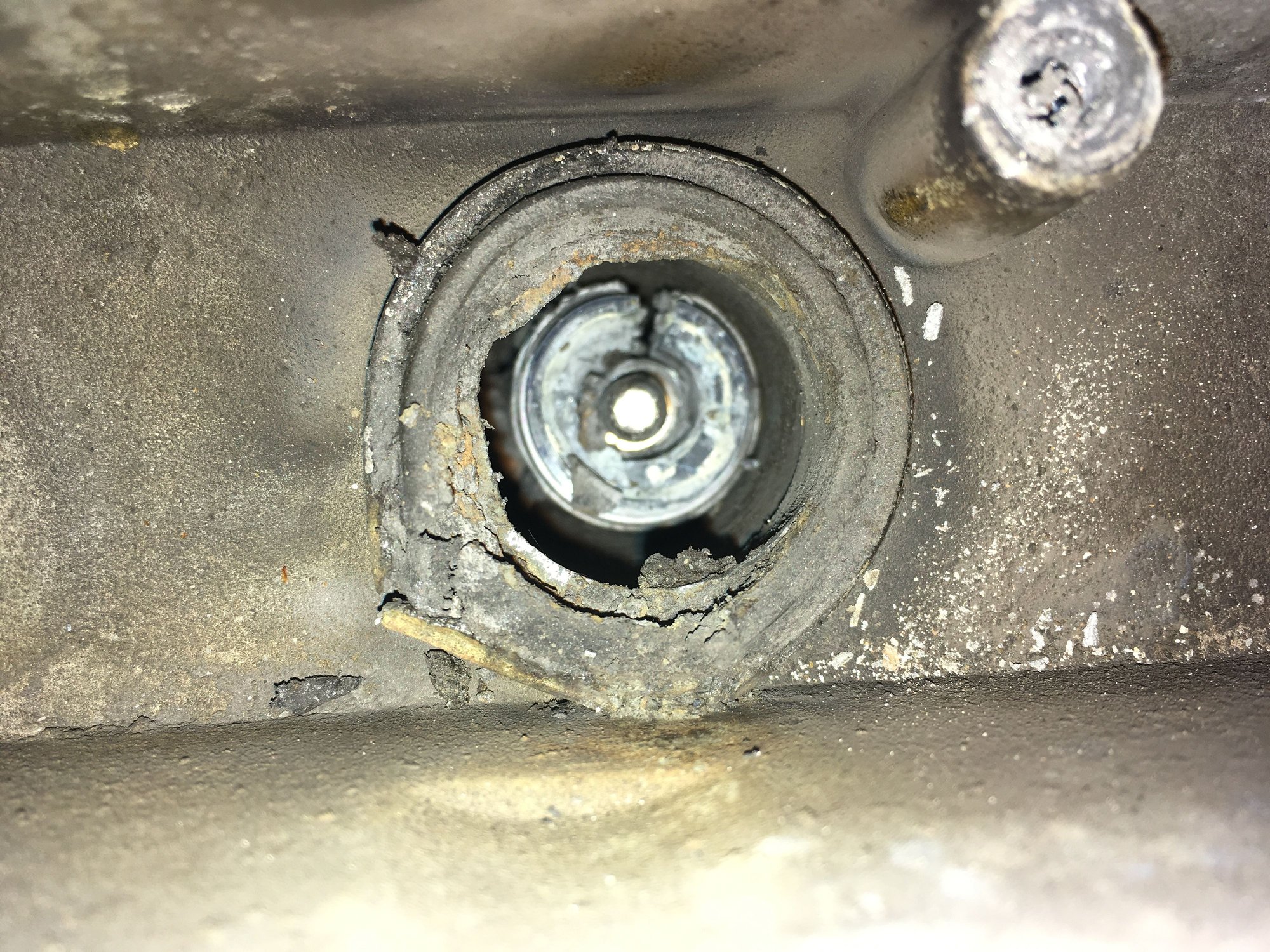

#1 spark plug hole with whats left of snapped coil stuck to spark plug in there.

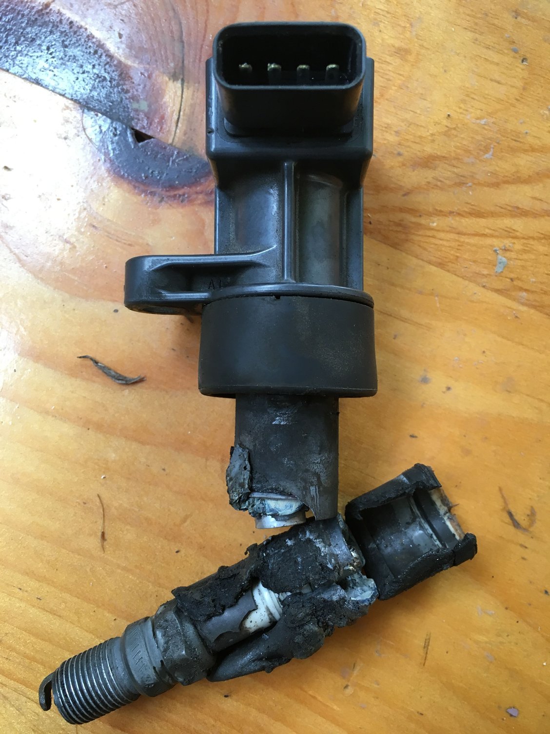

the remains of the spark plug and coil.
although the plug was not threaded into the head (either stripped threads or came unscrewed..havnt checked yet) it was not easy to remove. used a combination of small needle nose pliers, nippers and lastly when it was 1/4 out , vice grips
