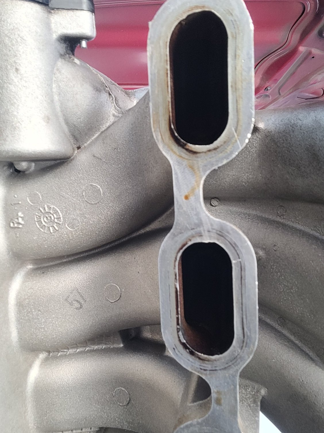

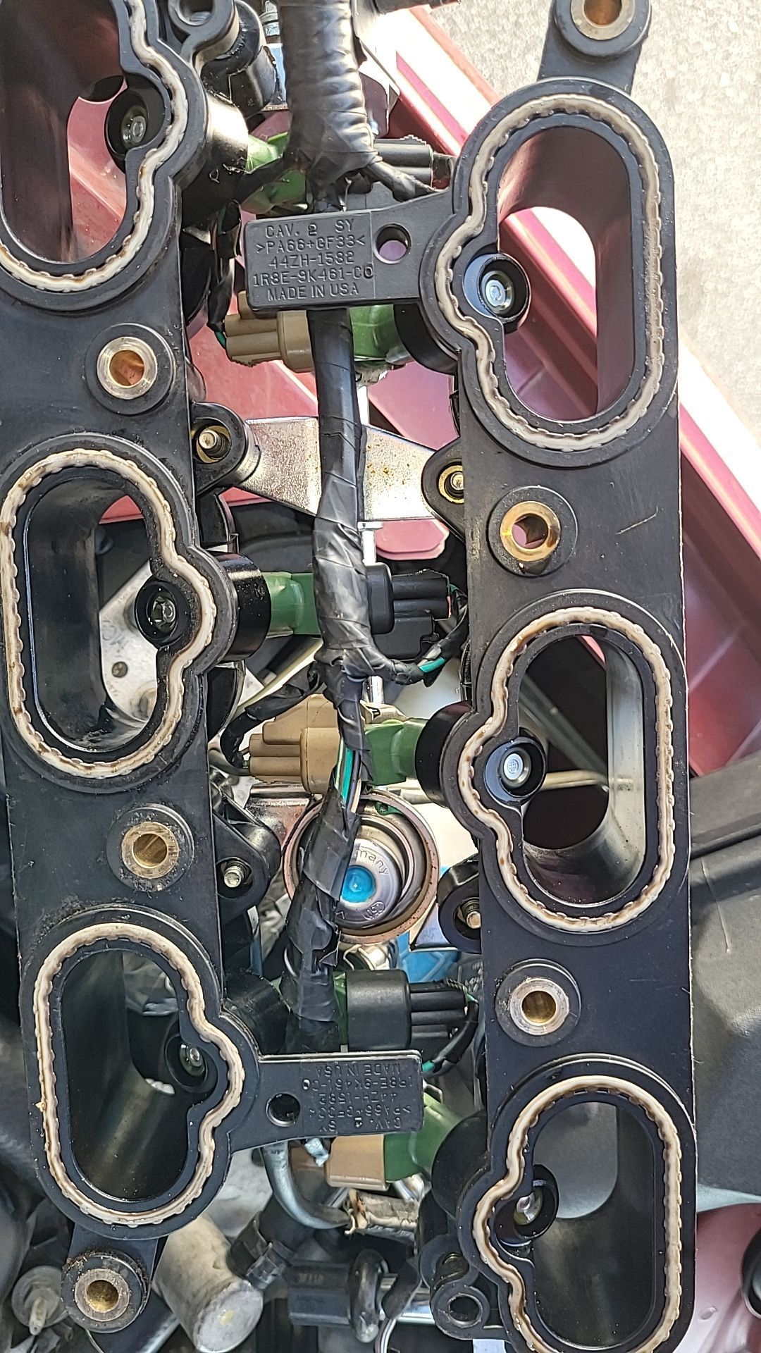

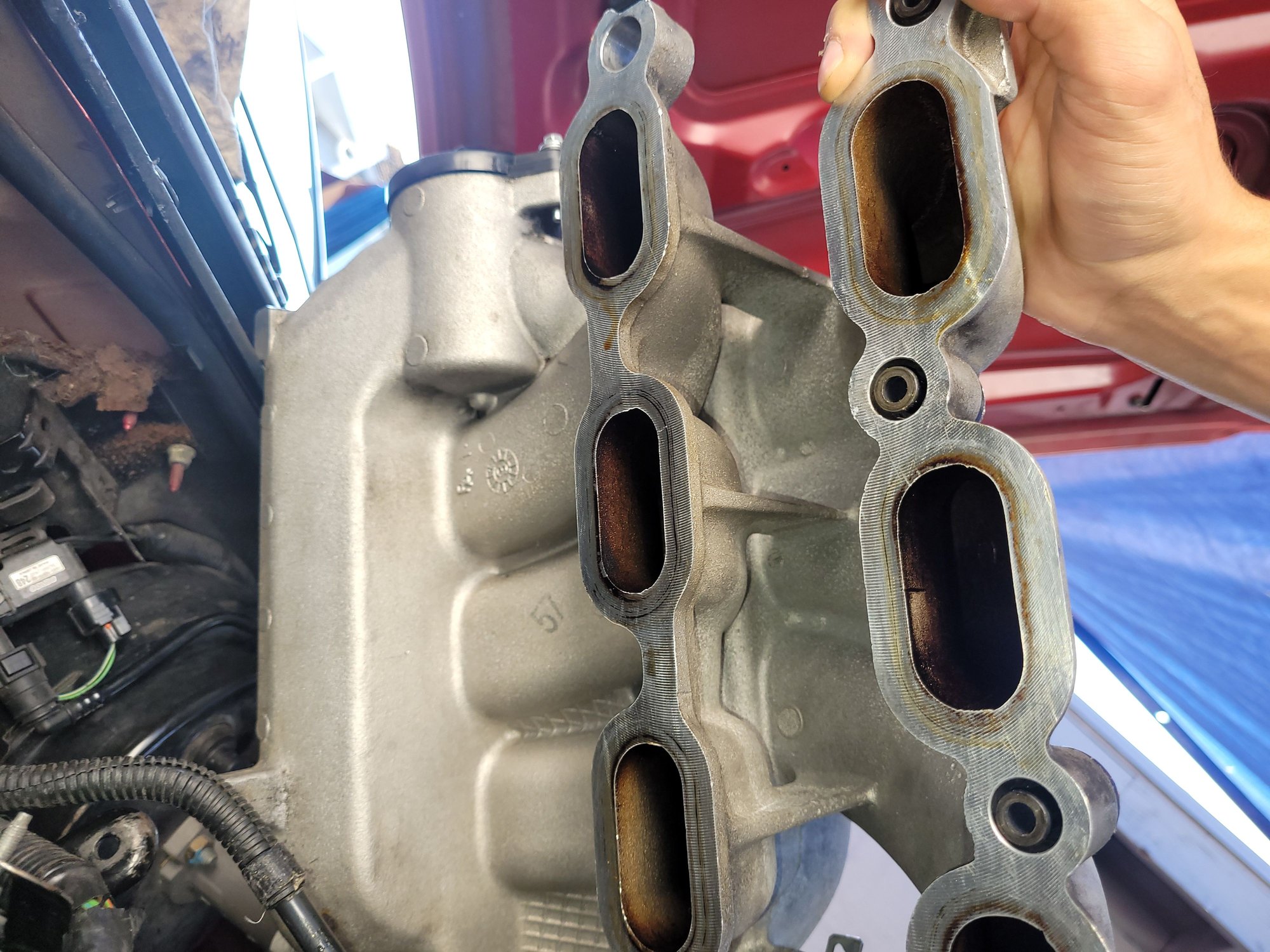

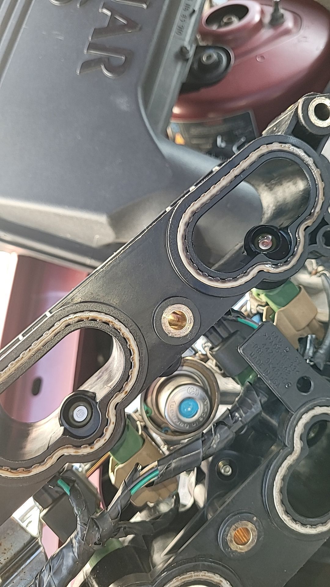

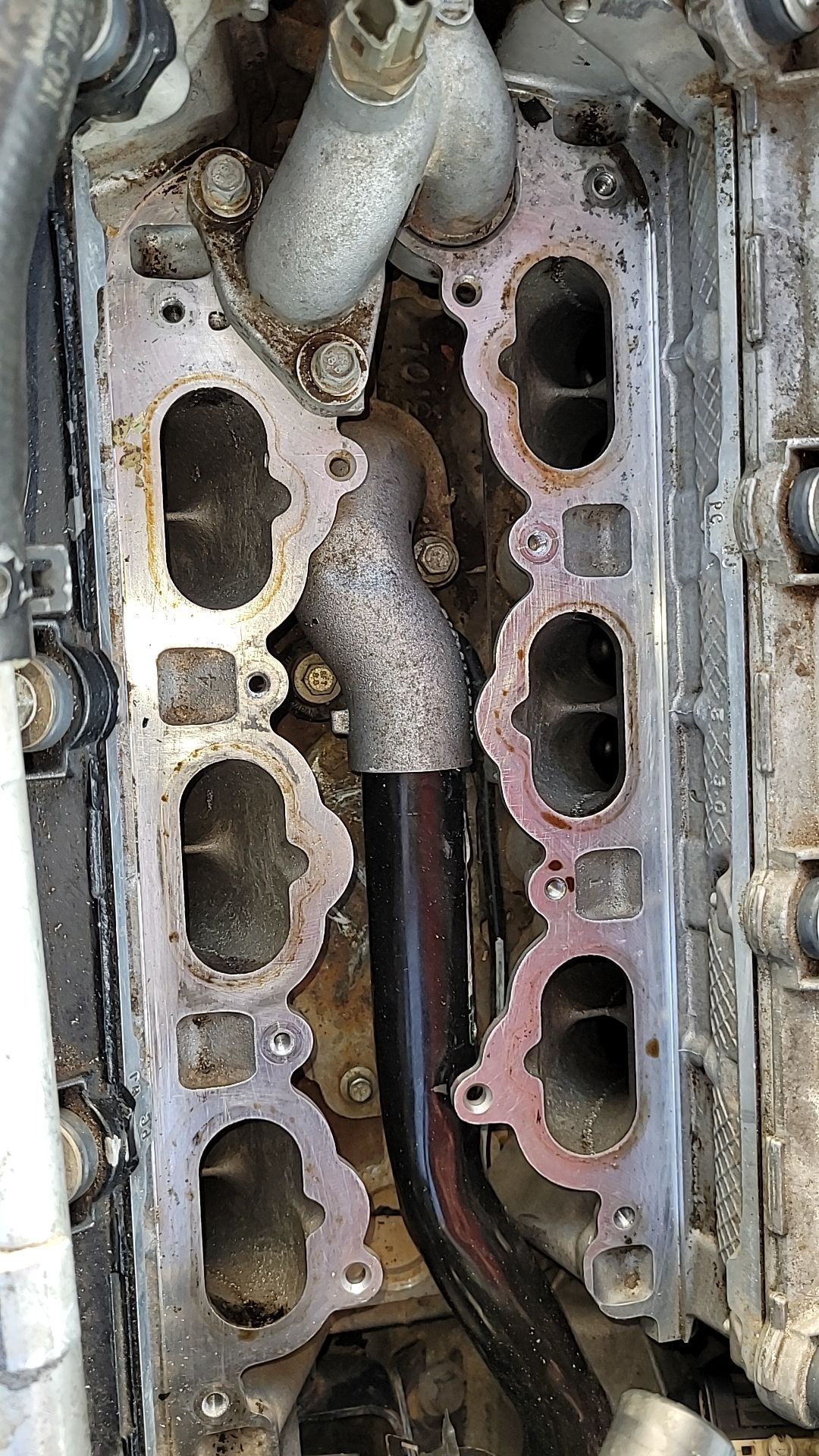

@Thermo @h2o2steam so I took out the lower manifold fold and while doing that there is oil on the main manifold and on the lower one. Also all the injectors are being fired by the looks of it except the 3rd one since there is no left over gas on the injector. I am going to be doing a injector test using 9v battery and see how many ohms I am getting but for now here are the pictures.
The seals look and feel brand new too...

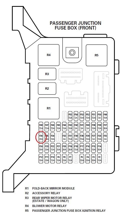

Sorry I meant F36 (20A) in the passenger junction fuse box inside the car.

It is in the passenger junction fuse box....listed as F36 in both the 2004 and 2005 schematics, so it should be there on yours.

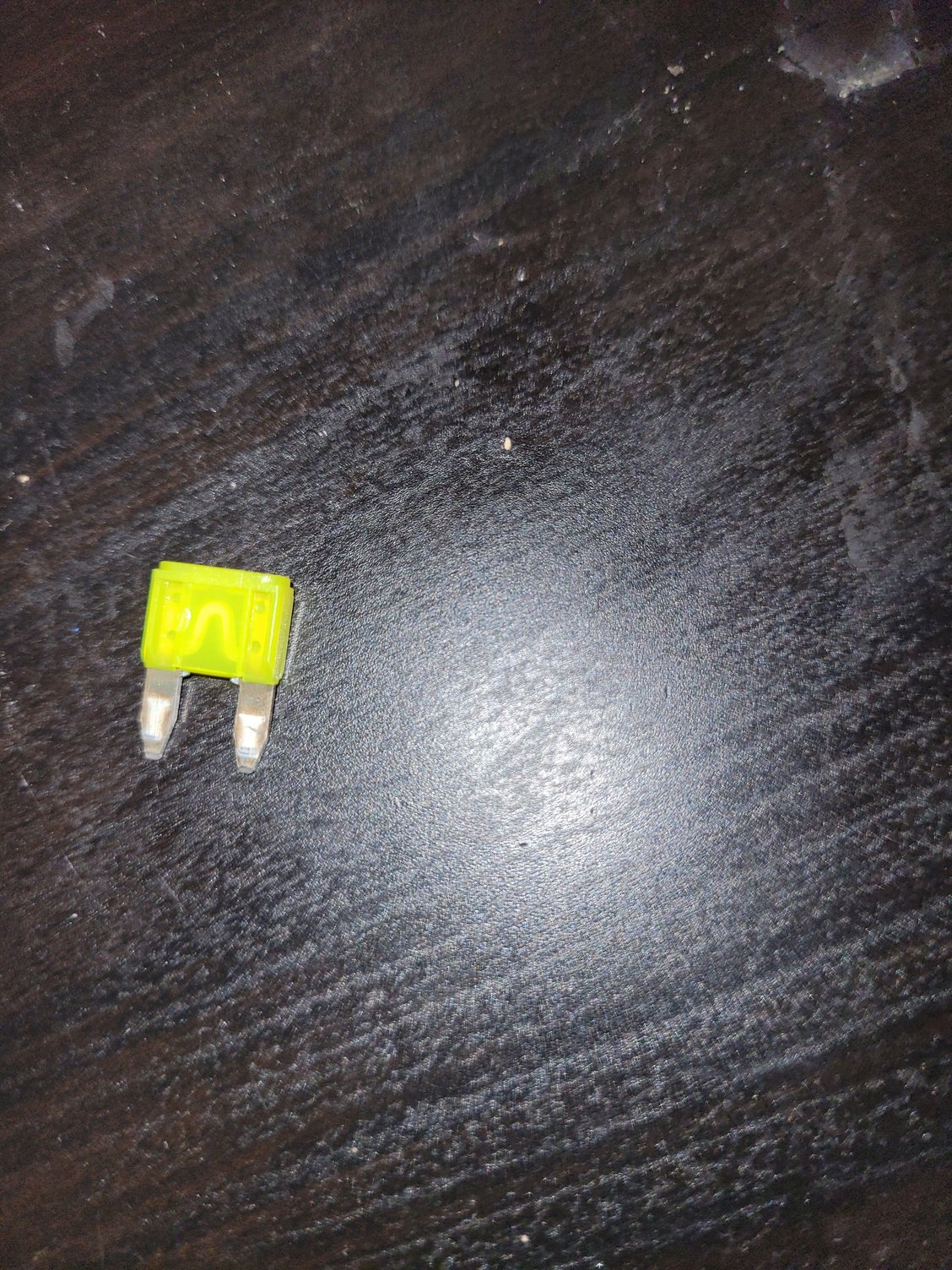

Okay, found it had my black led on the negative battery terminal and the red one on the fuse and it showed me 2v and I used the extra one and it shoes me 1v
This is the one that was in before
This is the one I replaced it with
