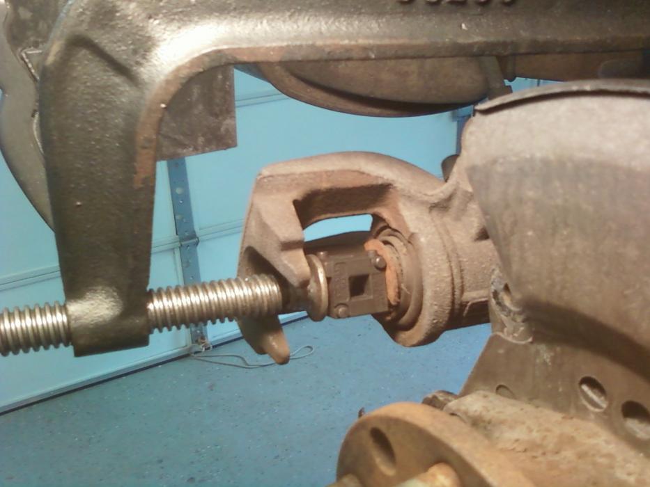

I want to thank everyone for their help in this thread as well as all the archived posts on brake pad replacement. With everyones help I felt prepared and everything went very well.
There were no shims or plates between the caliper and pads that weren't already on the new set of pads. Maybe some brake pads don't come with the plates, I don't know. However, I am starting to have second thoughts about using the anti-squeak on the rear pads. I'm wondering if it might interfere with the rotation of the caliper as they wear. Guess I'll find out. Also, there is no need to disconnect the parking brake cables. Just unhook the springs and the cable will have enough play to remove the caliper.
I was able to get by using just the caliper cube and c-clamp to wind in the rear calipers. I didn't need the caliper winding tool kit at all for this job. The trick to using the caliper cube is to have an extra pair of hands, a large c-clamp, a screwdriver, and a 13mm(?) socket. There's a nut on the back of the caliper directly in line with the caliper piston that the c-clamp will grab. Place the socket on the nut so the c-clamp doesn't damage the nut or slip off. Align the cube onto the caliper piston and tighten the c-clamp onto the cube and socket. Turn the cube with a screwdriver inserted through a side opening while your helper tightens the c-clamp. With 2 people, this worked out very nicely.
Sorry the pictures aren't clearer, I took them using my phone. The first picture shows the c-clamp on the cube. The second picture shows the screwdriver inserted into the cube.
On an unrelated topic, my driveshaft center bearing does not have the notches described in the X-Type FAQs to inject grease into the bearing. There's no way to grease it.
Attached Thumbnails First X complete brake job-photo0265.jpg   First X complete brake job-photo0266.jpg

wow! That is such a good idea for rewinding the caliper. I would have never thought of that. Thank you for the pics.

I can't take the credit for the idea. I read it somewhere but wanted to get a picture to make it easier for others to visualize. The caliper cube easily turned the piston but you can't get enough pressure to push it in. The c-clamp takes care of that but you need an extra pair of hands to hold it all together while turning. That being said, if someone's doing the job alone they'll need the proper tool.

I think the two rear calipers are wound back in different directions. if that's true you might want to describe that.
Also, on other cars I have found that opening the bleed valve makes the job a lot easier. What did you do?
Correct, the driver side is retracted by rotating it CCW and the passenger side CW. We didn't need to open the bleeder at all for removal. We just took fluid out of the resevoir so it wouldn't overflow during the process. We did a complete flush after we were done. The car brakes better than it ever did before and the pads aren't even broken in. I have to say, having a nice shop to work in, with plenty of tools and a great friend to hang out with really makes it enjoyable.
