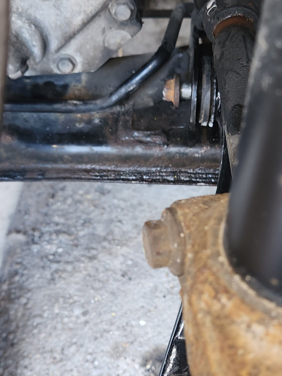

Angry Front driver's side control arm with bad ball joint
Started this today. OMG!! This is a p.i.t.a.!!!!!
Only thing that's going well so far is when I replaced these 5 years ago (& about 30,000 miles) is member Motorcarman said to install the bolt towards the rear of the car from the bottom up, with the nut on top. "It makes it easier if it needs to be removed in the future, and who knows it may be YOU!"
WELL it is me and glad for the advice. Other than that, 6 1/2 hours in and still not done, smfh. Every bolt and nut that could give me problems has. If I could have crawled into my house I would have I'm in so much pain. Did I mention f u c k cancer?
Attached the pics so far, yup it's definitely bad.
I tried to upload a little video of moving the ball joint, but this site won't let me. It wiggles with thumb and forefinger REALLY easily = not good.

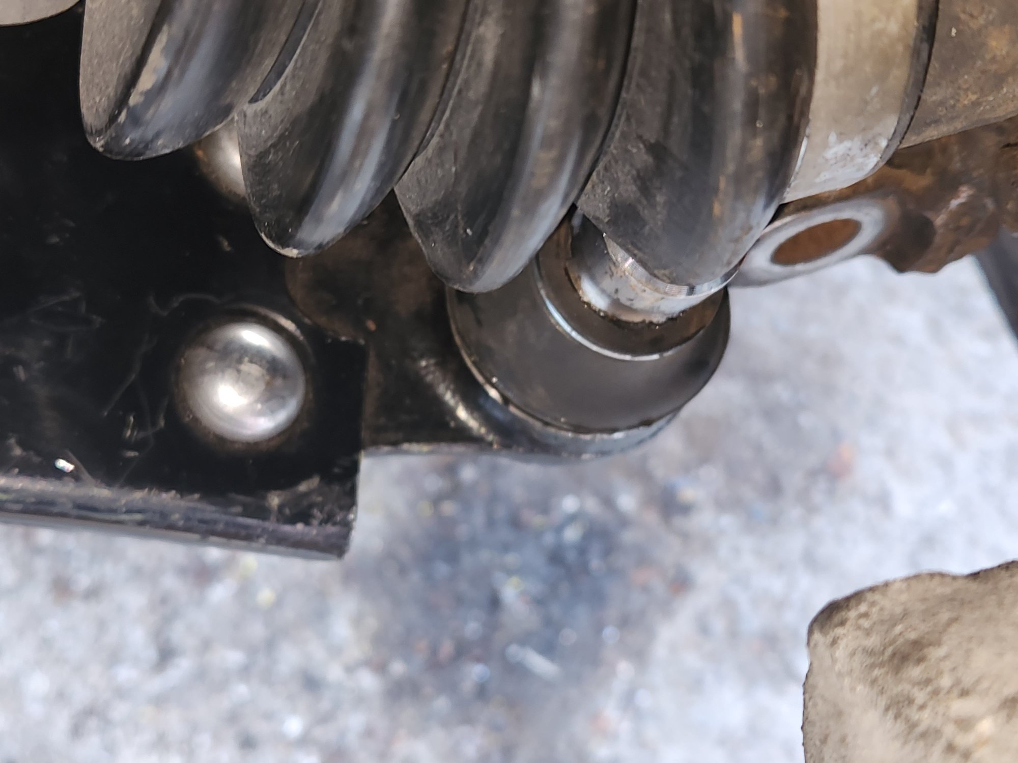

So every combination known to man to get this back in. Watched autodoc's video at least 10 times. He makes it look so easy = NOT!!
I finally got both back in (yes I know supposed to do 1 at a time but the car is not cooperating, smfh). 7 more hours today, and fighting through intense pain. Finally gave up. Attached where I'm at thus far and my kitty has been biting and scratching me, not including the 5 times the arm snapped under tension and crushed my fingers and finger tips. As the guy in England that did this and his videos are always some of the best documented and instructive = this job is a 10 out of 10 in difficulty.
