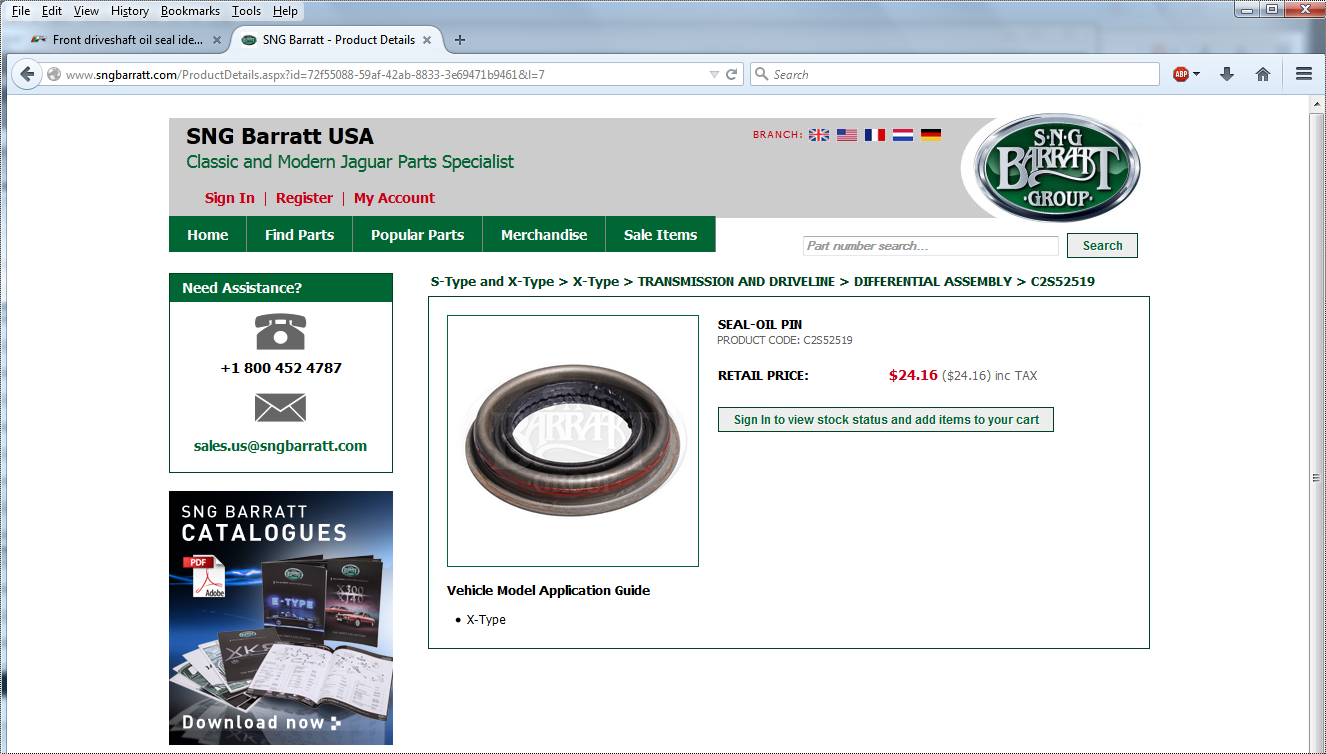

The current part number appears to be: C2S52519

I used the Jaguar Electronic Part Catalog (JEPC) that is available at the top of the forum in the FAQ area. Then copied the part number into SNG's web site and did some searching there. Sorry I misunderstood which end of the drive shaft you were looking for.
https://www.jaguarforums.com/forum/s...?highlight=EPC
SNG Barratt - The Ultimate Jaguar Parts Specialist
Also JPLV's web site: 2005 Jaguar X-Type Parts - Direct JPLV Porsche Parts.com
Here's the JEPC for the transfer case. It shows 3 seals. One of them is the one you have.
