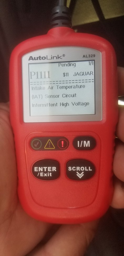

Not certain code P1111 means. Appreciate any next step thoughts. jrd

P1111 means all tests performed and passed

The DTC is likely stored in the TCM and not in the ECM.
P1111 means the ENGINE is happy but what about the gearbox?

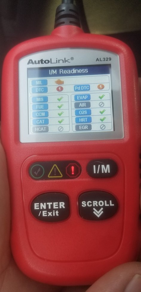

Finally code PO778. Appreciate any comment. Thank you!

Thank you so much for your input Thermo! PO778 was pulled.
