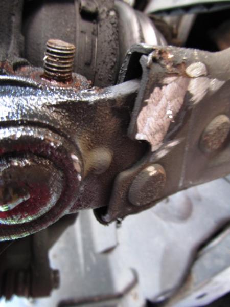

s'not going well!!.
ground down the head of the first rivet, but cannot get the rivet out.
Tried to remove the pinch bolt holding the knuckle to the ball joint, but the bolt is siezed.
Any one know what size torx bit the bolt is?
any ideas?

I gave up on the balljoint...without an oxy/acet torch to heat up the pinch bolt figured i was wasting my time grinding the rivets.
I took it to a shop just up the road where they charged me $25 to replace the BJ....i was chuffed with the price and gave them $40
