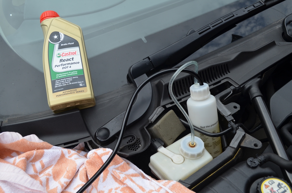

Here's the way I set the Gunson up on my XK today (much the same as every other vehicle I've used it on):
The Gunson feed tube is short so the fluid bottle can't be very far away from the brake fluid reservoir.
A little improvisation on a container to catch the drained fluid:
You can see it is actualy draining as I took the photo. The whole process really is that easy.
Used 750 ml of brake fluid.
