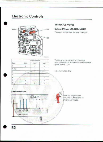

The Jaguar X-Type, Mazda, VW, Range Rover all use the JATCO JF506E.
The VW 09A JATCO JF506E gearbox has an issue with the N92 valve (and some other valves). The trans will not shift out of first because the valve is stuck closed. It needs to OPEN to shift to 2nd and it is not closed again until 4th gear is needed so until a high enough speed is reached to get to 4th, you will NOT shift out of first. I repair more of these VWs because there are alot more of these. Maybe the VW fluid is different and causes the sticking valves??????
The TCM might NOT flag an electrical fault because the valve is in the circuit and reads fine. The valve becomes mechanically stuck!!!!!!
There are 3 valves that shift all 5 speeds and the other 6 valves are for shift quality (9 total).
There are other reasons for the fault but it could be a stuck valve.
You might check the fluid level, TCM DTCs etc.
