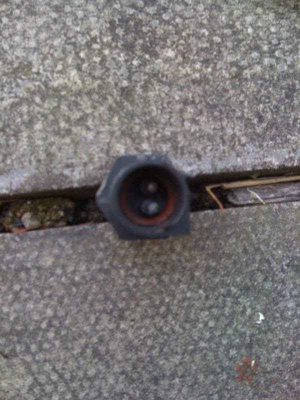

Taking a look at my old sensor it was clear to see why it had malfunctioned. Excuse the quality of the picture (taken from my phone) but inside there is quite a bit of corrosion.

And that's it. My heater display is now showing an accurate outside temp and my aircon is all working exactly as it should for only £5 or £6. Well worth doing if only to eliminate this sensor from your temperature problems.
