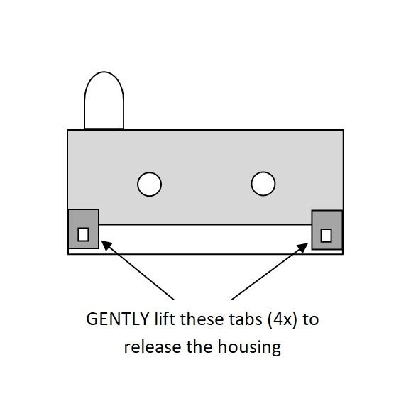

I recently bought a X type 3.0 with the same problem.
How I fixed it:
Carefully pry open the original microswitch and LIGHTLY sand the contact surfaces by putting a small strip of thin sand paper and then pulling it out. You can put a VERY thin layer of conductive anti corrosion grease (copper grease) to help with operation as well. What's happening here is that the contacts that make a complete circuit when the car is out of P and R can arc during opening and closing and this arc creates a layer of oxides that prevent the contacts from conducting electricity.
No money spent and no cutting/soldering wires!!
