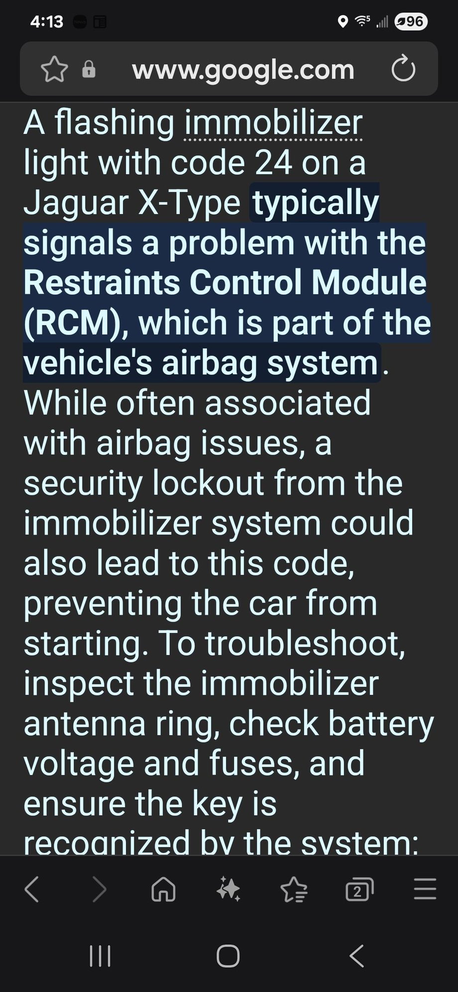

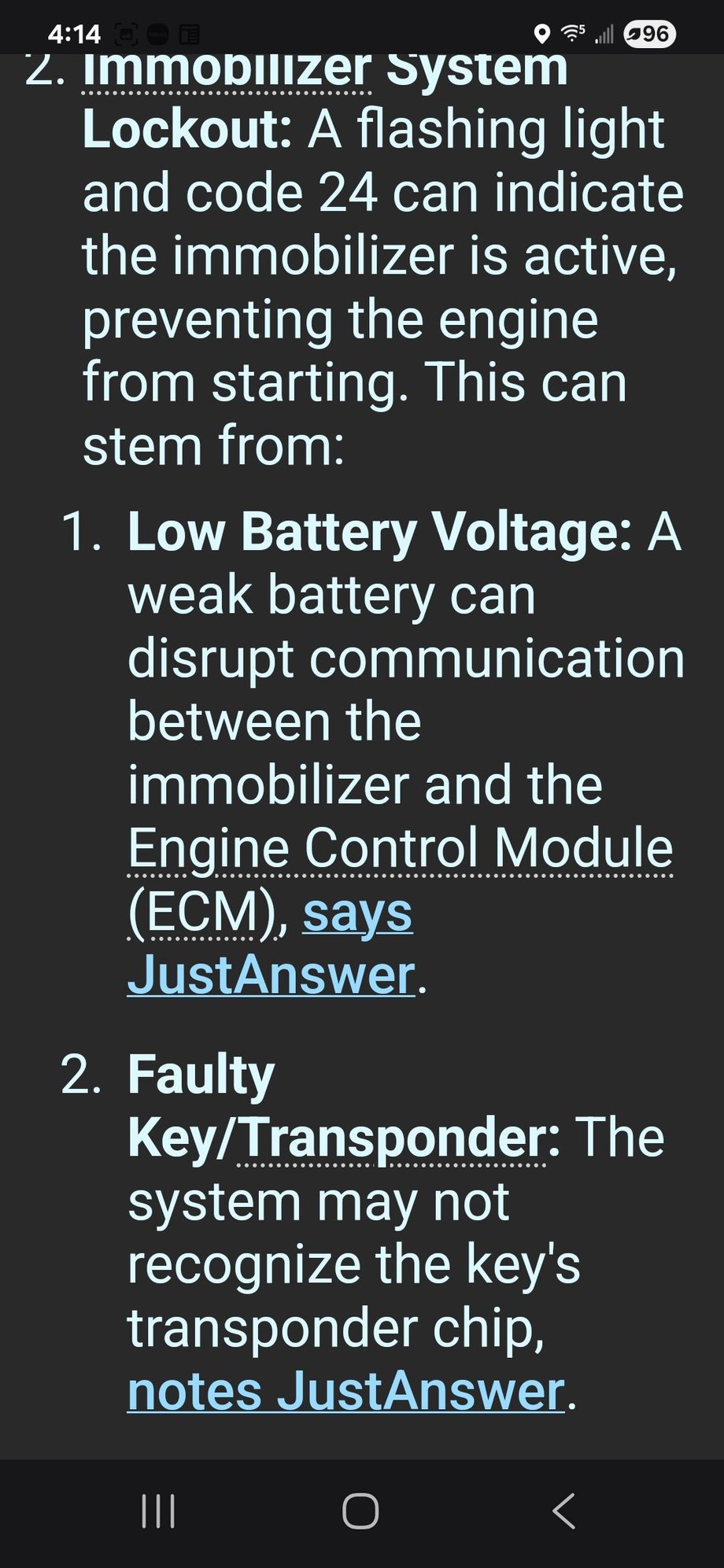

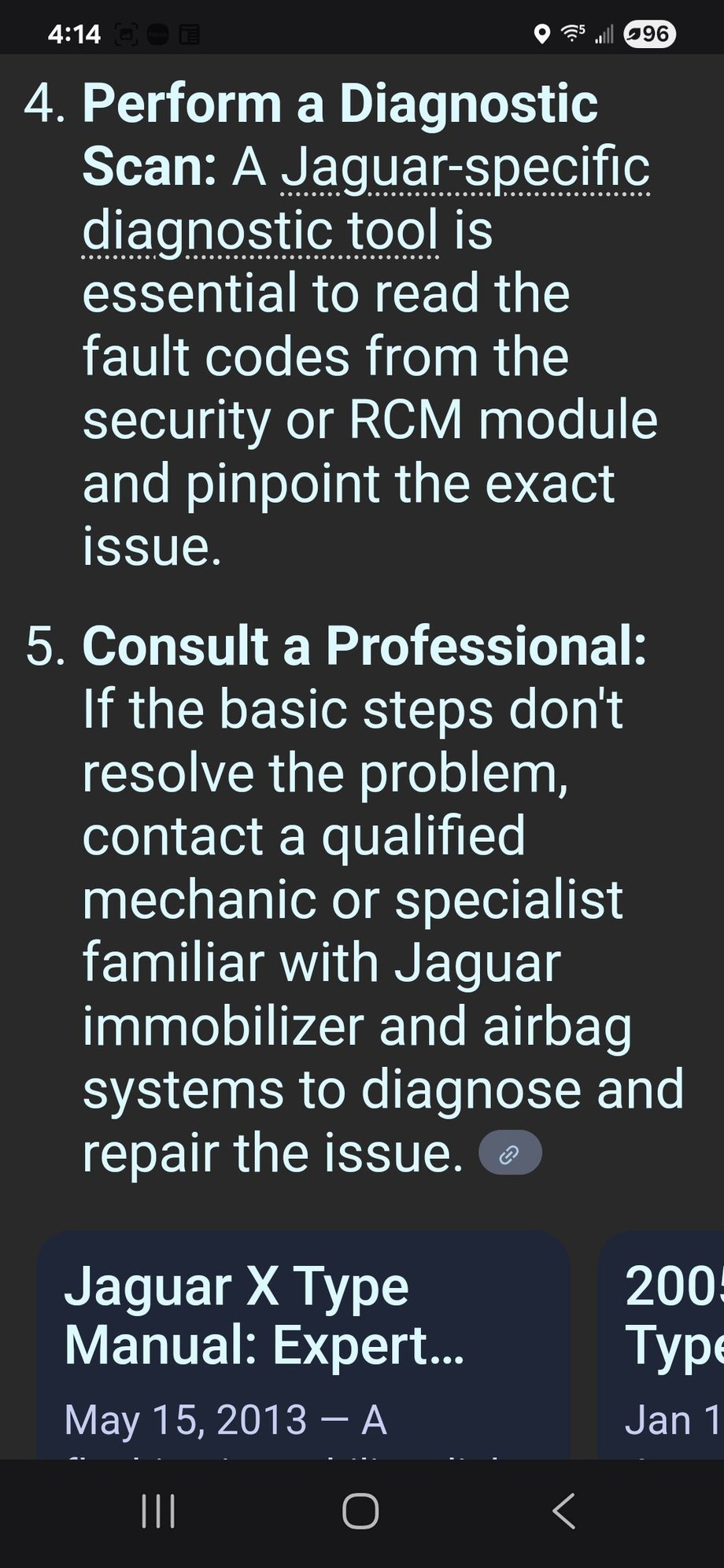

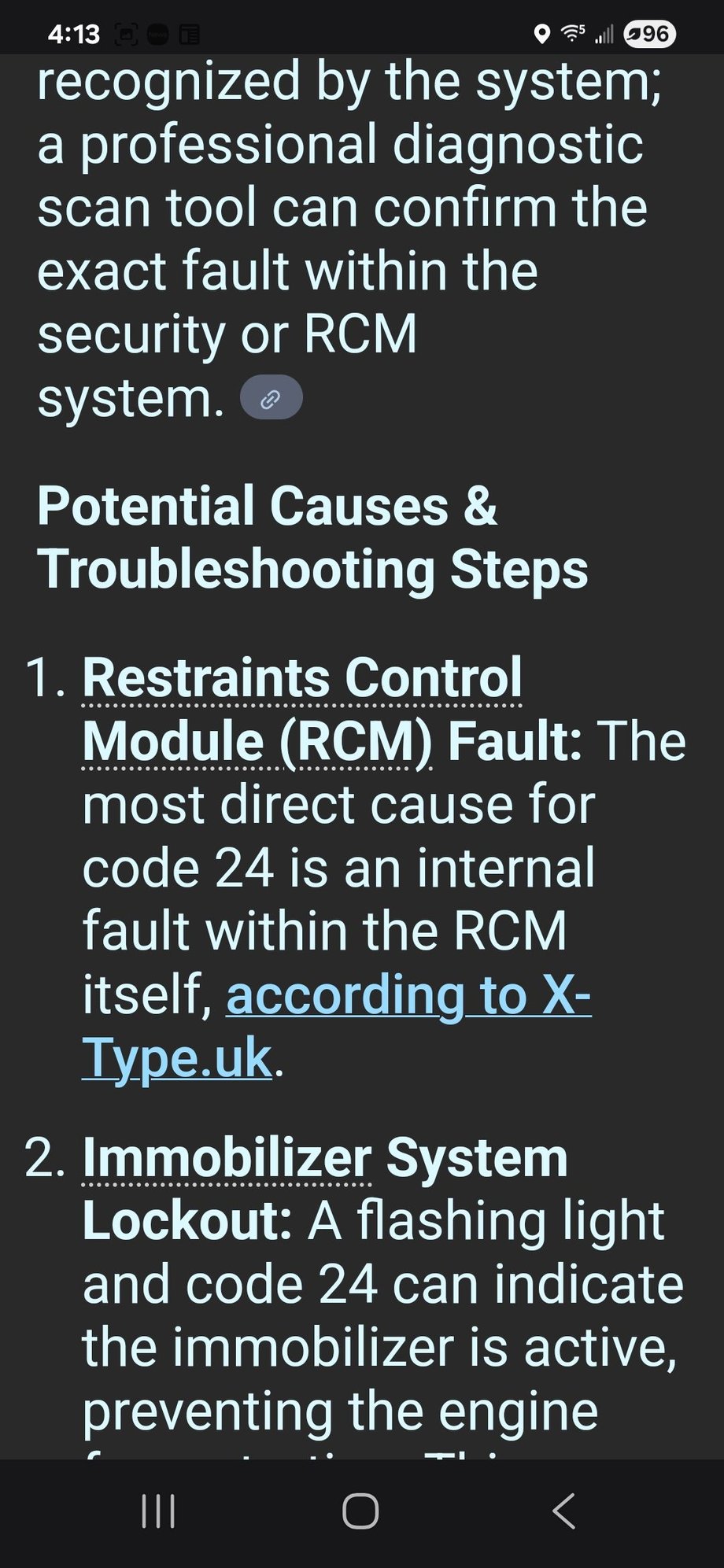

I have a Jaguar 3.0 X-Type That's it for about 3 years when she parked it and only needed a oxygen sensor and a battery I bought a new battery and a oxygen sensor but I'm getting gear fault also codes p1638 p0102 p0112 p1699 p 1000 also the red light by the gear shifter when you put the key in turn ignition from one to two position three times it blinks one two three four stop blink blink one two three four blink blink which I looked up and indicate pat mode so can someone please take me step by step on what to do to get this car to turn over you can turn the switch no nothing no starter no nothing but you can go out and touch the starter with the screwdriver and it turns up but it seem like it's not getting fired when you turn it over by the screwdriver please please step by step help somebody anybody but I can get your car up and going
