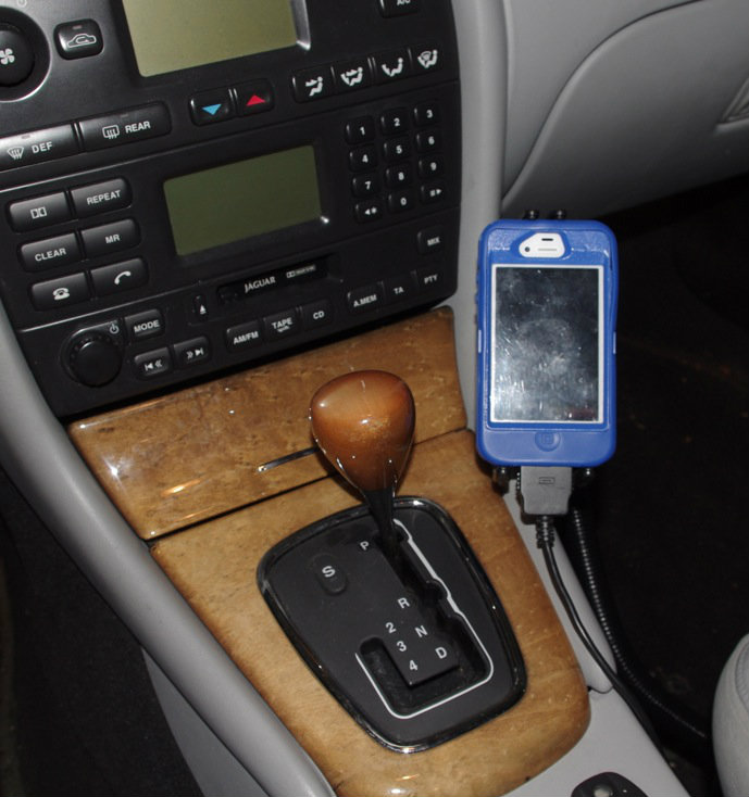

1. I'd put the USB in the center console and the iPod connection, I'd run that from under the passenger side of the center console. Thats where my ACM iPod line is so I can use a neat dock that I found on eBay that attaches to the seat nut!

Attached Thumbnails iSimple IS32 Install - Advice/Ideas Needed-file-15.jpg
