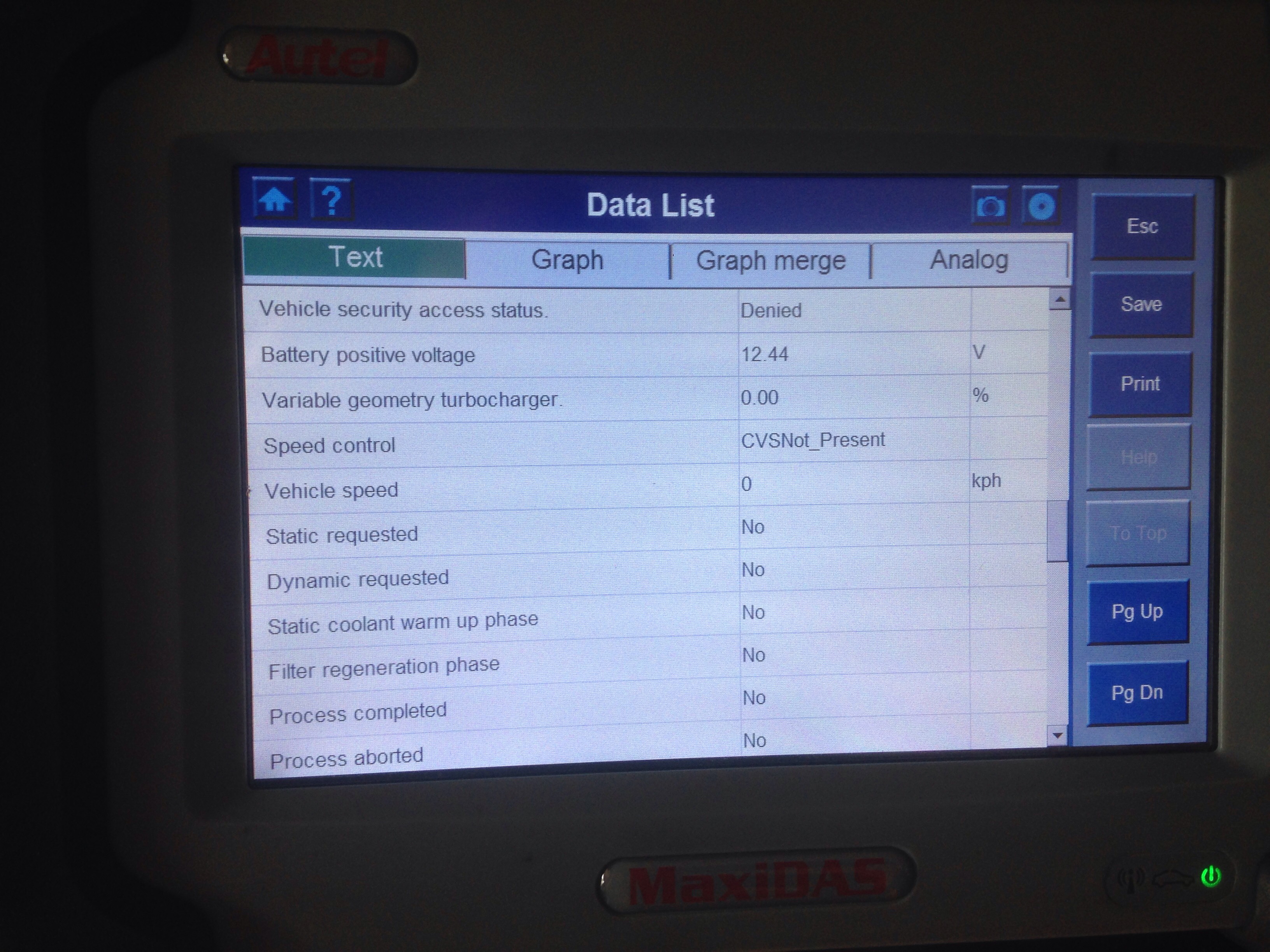

Old Apr 16, 2018 | 02:27 PM
nickygrimston's Avatar
Joined: Mar 2018
Posts: 3
From: Mallorca. 07560
Default see attached.

Nicky, well, you can replace all the sensors you want, but if your security system is denying you the ability to start, the car will never start.
With this being said, try starting the car with a different key. We have seen where the computer will loose the programming for a key and it will suddenly not let you start the car with that one key. If you happen to have more than 2, try all of the keys.
Next, turn the ignition to the RUN position and then put your foot on the brake. Shift the car to NEUTRAL. With your foot still on the brake, turn the key to START and see what you get. Make sure to look down at the center console to look at the red LED next to the cup holders. Is that red LED light on? If yes, then this is confirming a security lockout.
Have you noticed that your instrument cluster has been giving you funny indications (ie, a gauge not working, none of the gauges responding momentarily then jumping back to where they should be)? If so, then odds are your problem is related to the instrument cluster.
That should give you a place to start.
