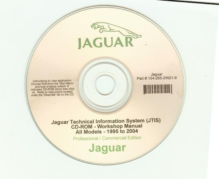

Hi
I just want to remind forum members that the JTIS21 Jaguar Shop Repair Manual is a free download here on the forum.
Here are 2 JPEG files:
First One is a scanned image of the JTIS21 CD:
https://www.jaguarforums.com/forum/a...1-cd-image-jpg
The other one is screen capture showing the 2004.25 X-Type selected and has the table of contents displayed. The fuel tank and lines is selected.
 Jaguar Technician Information System (JTIS) download-jtis21-x-type-2004.25-table-contents.jpg
Here is the JTIS21 Download file and download information thread, go to post #1:
New JTIS21 CD download with download instructions
Review all the posts in the JTIS21 thread - they give some insight on install and use issues.
