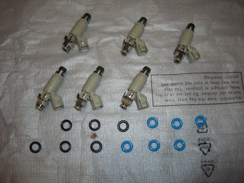

Hi Guys
I recently had my Fuel Injector and Fuel Rail changed. I have attached images you might find helpful.
Whoever does the changes I have done make sure of one thing that the bolts should not be tightened beyond 10nm. Its not a very difficult job if you have a little skill. All you need is good weather and a weekend. You can save lots of money.
