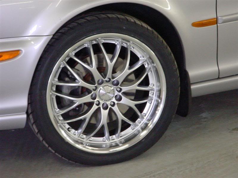

Old Nov 29, 2007 | 09:58 AM
RudyF6's Avatar
Posts: 695
Likes: 196
From: Michigan
Default RE: Jaguar X-Type rim ET (offset)?
Your rim choice is absolutely the best. (I'm biased, of course )
225/40r18 18x7.5 w/40mm offset - no rubbing.

Old Nov 30, 2007 | 11:26 AM
nineball's Avatar
Joined: Jul 2006
Posts: 475
From: home
225/40r18, 18x7.5, 40mm offset
