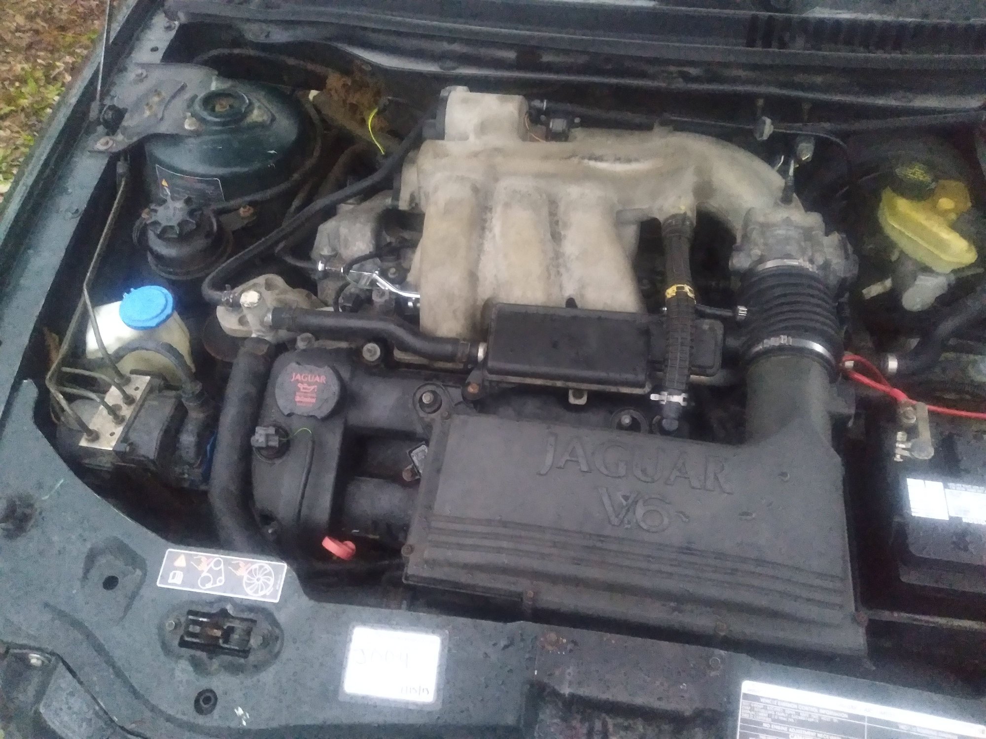

I wasn't able to check the ground points today because of rain I did check my fuel regulator hoses and seen no issues with them but I'm going to do as you said and check all my ground points first to see if that helps.and if not ill switch out fuel regulator also keep saying supercharged bc it's a jaguar x type supercharged.

Old Dec 17, 2021 | 04:59 PM

I think the "superchrged" badge was an aftermarket addition as the supercharged X was a one off experimental development that the only existing one was gifted to the Jaguar Heritage Trust.

I'm guessing it was added to it to since whoever owned the car before me had put a cold air intake turbo fan in it?only thing I see under the hood that was added to the engine

Kem55esh, remove that fan. Tests have been done and they have found that it actually sucks more power via the electrical system than it helps the engine create. So, you are losing power with that in the intake. Just saying. that may be causing your rich condition too as it is restricting the air flow possibly and that is causing the ECU to over fuel the cylinders.

I seen the grounds here was they the ones you mentioned ?and cleaned them plus a couple more by the abs system and still no difference i will pull the fan out tomorrow and look for more grounds to clean thanks for all the info andd advice 👍 any idea where the earth ground is located so i dont have to search?
