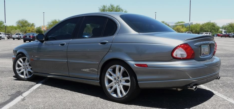

H&R springs dropped my X-type about one inch or more all around.

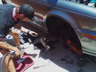

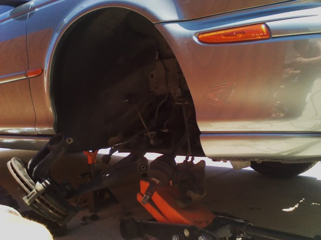

A few weeks back I contacted JaggyX about a set of H&R springs he had for sale. Jaggy basically gave them to me, $100, and today my buddy David removed the stock springs on my X-Type and replaced them with the H&R’s. My friend David is a mechanic; Me? I just handed off tools, and moved the floor jack around. It's the best I could do without getting in the way.
The front end was quite a job - to say the least. We had to pull the wheels, brake calipers, tie rods, and drop the A-arms on both sides, just to get to the spring/strut assemblies and remove each one. The front springs took about 2 hours to remove and replace. Luckily D boy has air tools, this made dis-assembly & assembly go quick compared to trying to turn every nut & bolt by hand with ratchets. Plus, his air ratchet has a torque setting for re-assembly! At this point it’s just about knowing how to take it all apart, and, get it back together exactly how it was in the first place. Lol!
Rear End: It was much easier to R&R the rear springs. For one, we didn’t have to pull the wheels off. We simply jacked the rear end up pretty high, and removed the large (alignment) bolts holding the lower control arms to the frame, and then dropped the arms to free the spring/shock bundles. The 2 rear springs took about an hour.
The ride quality is the same... taking it easy over speed bumps...
[Total front & rear springs replaced in 3.0 hours]

"Wow so you need to remove the tie rod ends to get to the struts? Calipers as well? I watched a youtube video on changing the stuts for the xjr (I think) and they didn't have to remove the calipers, or the tie rod ends if I recall."
Basically, I removed the strut assemblies, changed the springs to HRs, and put them back from whence they came..Then I replaced the rear springs with HRs.
I'd say it's somewhat of a fine art to get the struts assemblies re installed correctly. Elbow grease is one thing, but knowledge of the suspension lay-out is key. Enjoy the pics.
