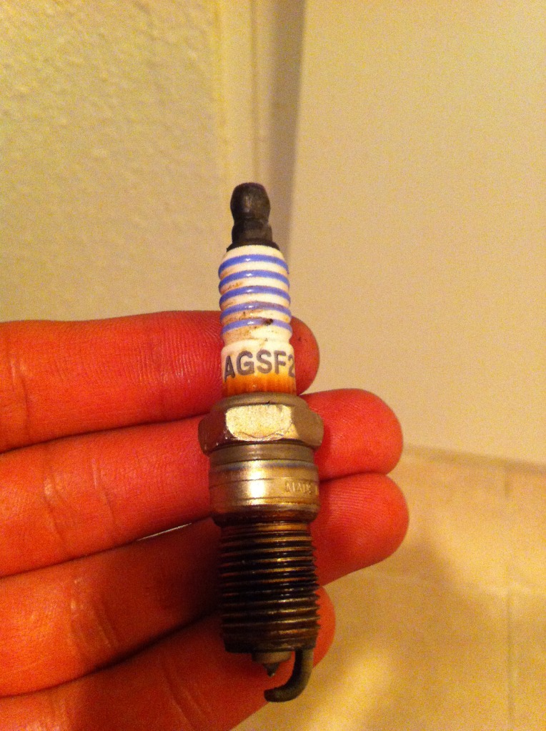

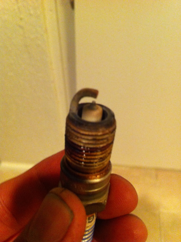

Thanks to the many easy to follow instructions in this forums and a helpful YouTube video I changed the spark plugs and upper intake gaskets in 40 minutes. It was extremely easy thanks to all the instructions. Not as easy as my straight 6 XJS, which an elderly blind person could probably do in 10 minutes while simultaneously watching wheel of fortune, but nevertheless very doable for anyone with the appropriate tools.
I was hoping that this will improve my tragic MPG. I have ordered a new PCV valve since the manifold was full of oil. Cleaned the MAF throttle body again.
I am not getting too excited about MPG though, because the spark plugs that came out where in pretty good shape:
I think those are Motorcraft platinums based on the number, so I don't think they are original.

How interesting.
The plugs that came out of my car are exactly the plugs this member removed in this post:
https://www.jaguarforums.com/forum/x...k-plugs-85327/
Identical markings, so I guess mine where original. Based on those number these are Motorcraft SP-459
