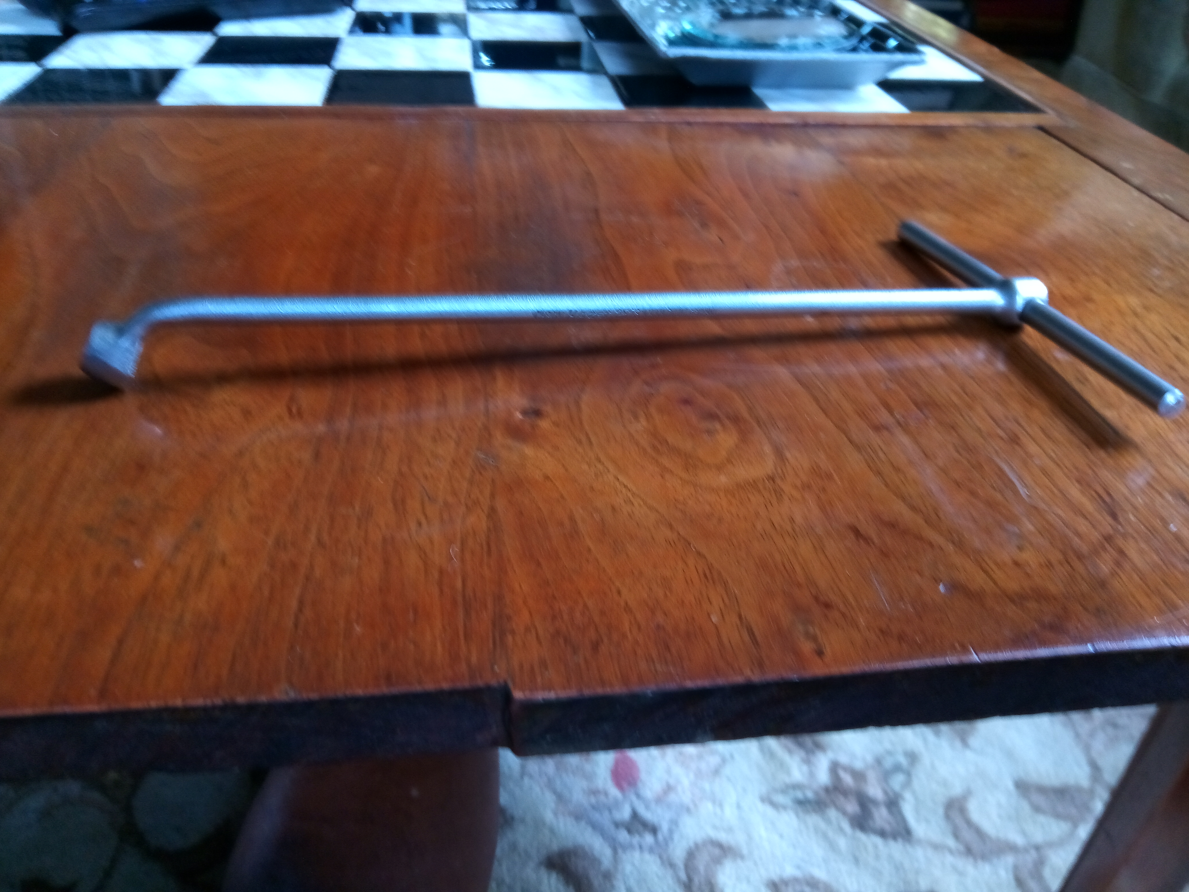

Default Helpful tool for coolant pipe
Originally Posted by Patterson
I've been having miss fires and some other trouble so I'm in the middle of spark plug and coil pack change. I decided to r&r the lower manifold gaskets while I have the upper manifold removed. I also wanted to r&r the knock sensor since I have things apart, but I'm finding that I have to remove the steel coolant line that runs under the fuel rail. I tried everything to get to the one bolt holding the knock sensor in place, actually I can get a wrench around it, but it won't budge. I even hammered/tapped a very tight fitting open end wrench (3/8th inch) onto the bolt head. Still could not get the bolt to turn, wrench slipped off. As tight as it is, I can see that for a box end wrench to work I would need to apply force along the axis of the wrench and the turning force at the same time in order to keep the wrench on the bolt head.
Ideally, it needs a socket to contact all six flats of the bolt head in order to turn! What a pain as I really don't want to disturb the steel coolant line. I don't have a knock sensor code, but my X has 150K miles and I was hoping to do this as preventative. I figure I'm going to just carry on with the tune up and put her back together. Would have been nice if the engineers had made clearance to remove the knock sensor easier. That said, I haven't seen the side mount KS that is on 2003 models. Curious how easy that is to r&r.
Hello, found Hazet 10mm T-wrench #2573 did the job.
Attached Thumbnails Knock sensor locations 02 X-Type 2.5-img_20180506_144858.jpg   Knock sensor locations 02 X-Type 2.5-img_20180506_144803.jpg   Knock sensor locations 02 X-Type 2.5-img_20180506_144842.jpg

Very nice, yes that would have cracked the bolt loose. It grabs all 6 hex flats, I haven't seen one of those. Would like to have a few actually, 8mm, 10mm, maybe 12mm.
I ended up relocating the KS as you know. I'd prefer to do it correct, using that tool, but luckily I read that French man's post on JF here; smart guy! Like I said, I don't have a KS code, but that thing has 150K miles on it, and I don't plan on creeping this deep into the engine very often.
