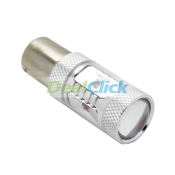

The Bulb You Need: Bau15s (aka: 150° 7507, PY21W) with the "Y" shaped base.
I am a fan of LED's and have spent soooo much money buying and trying different bulbs. My main issue with LED turn signals is that I was never able to find a set that was as bright, or brighter than their incandescent counterparts (making it a safety issue).
It wasn't until i found these Cree XBD LEDs with 4 radial chips and 2 inside a little projector and they completely DESTROY incandescent bulbs in terms of brightness.
Granted these aren't the Error Free kind, but you can just add resistors. BUT on these Jags the "hyperflash" is only a sound effect and if you look outside they still flash normally. So in my case I just ignore the fast blinking sound (plus my exhaust is loud enough that it doesn't even bug me).
2X 30W BAU15S 150° 7507 PY21W High Power CREE LED Turn Signal Light Bulb Amber | eBay
