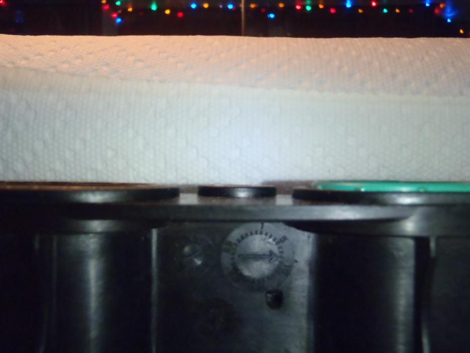

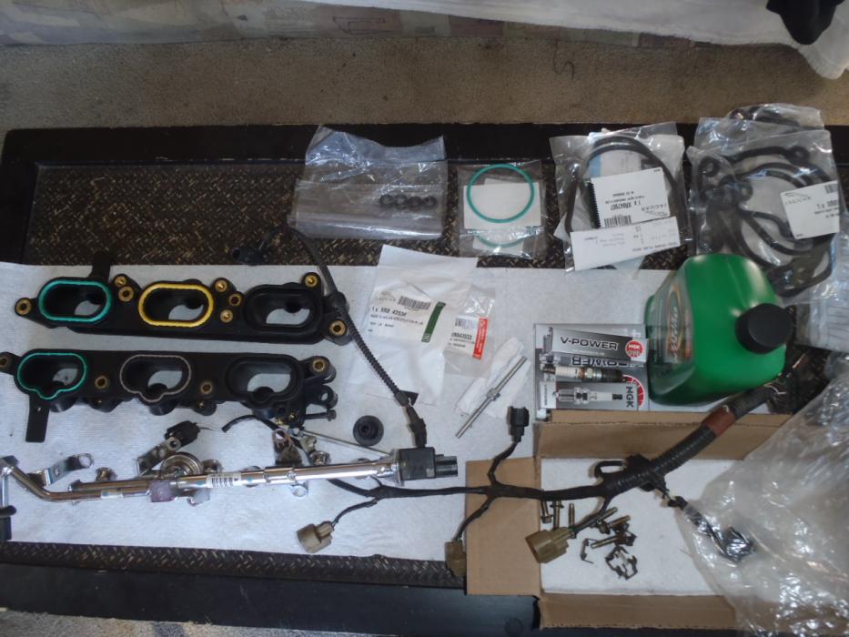

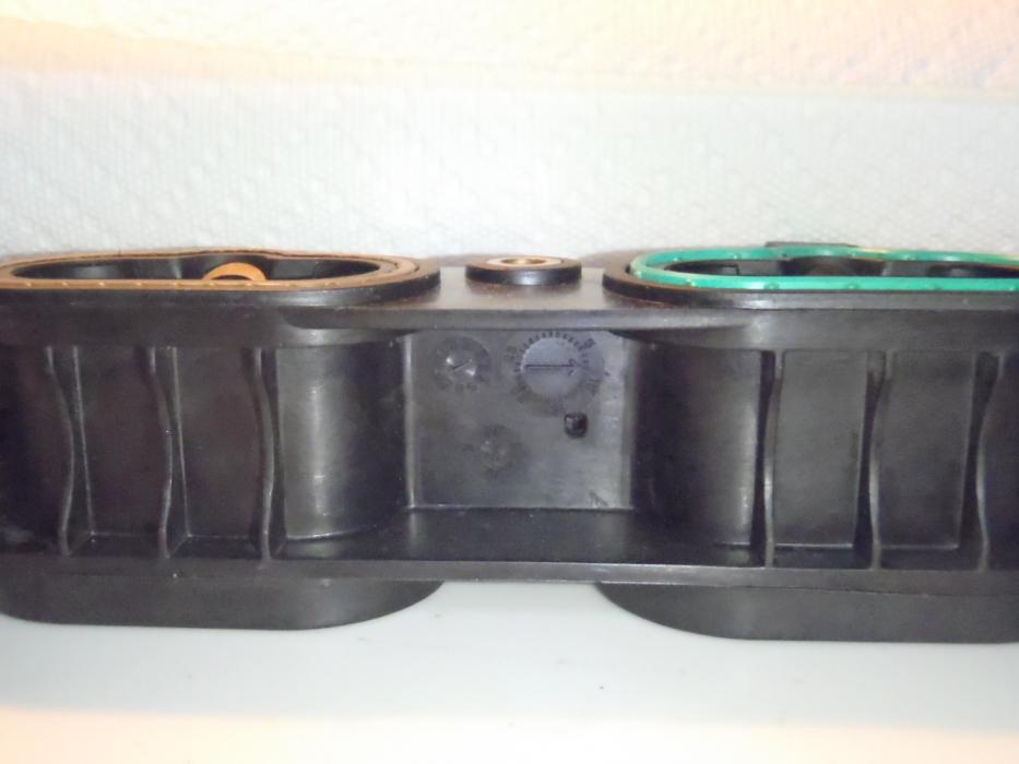

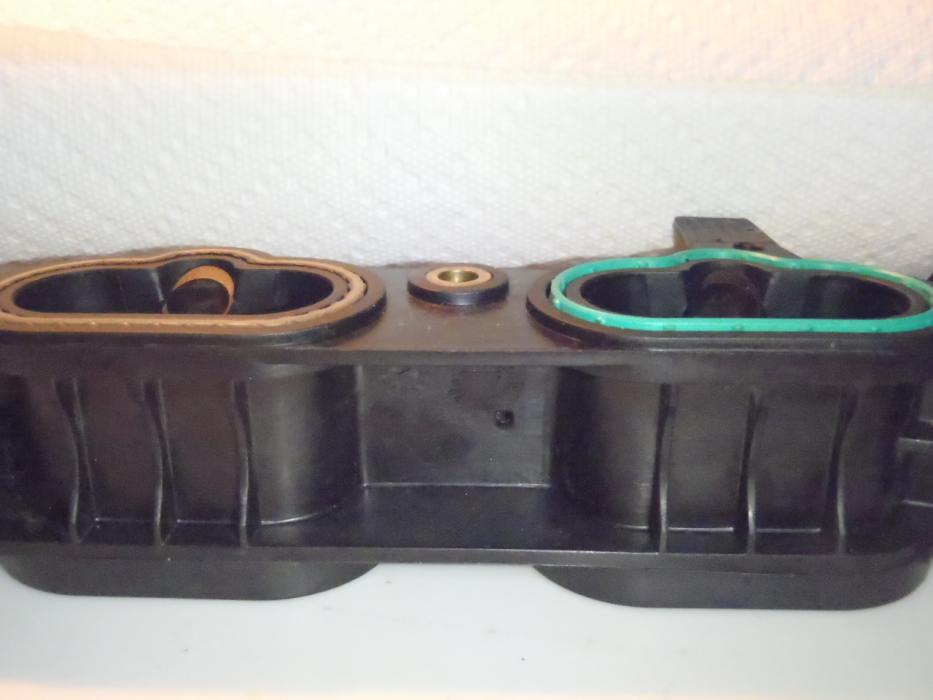

ok. i just had to post these pictures. im guessing this was definitely an issue, and i am beginning to think that this might solve my problem completely. what do you think?

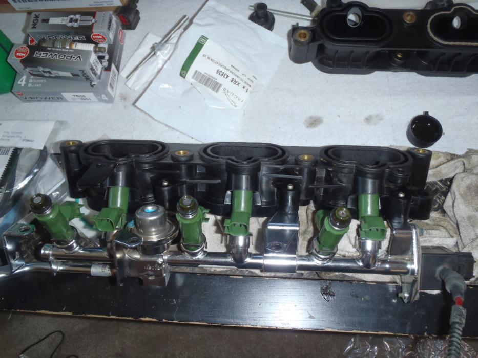

hope everyones holidays were good. well after 2 weeks, the rain has finally stopped for a while. yea! today i will clean the fuel injectors and assemble the fuel rail . i will post some pics as i go along. feel free to jump in anytime with any comments.
Old Dec 27, 2010 | 02:19 PM
jonsjag's Avatar
Joined: Oct 2010
Posts: 19
From: fresno california

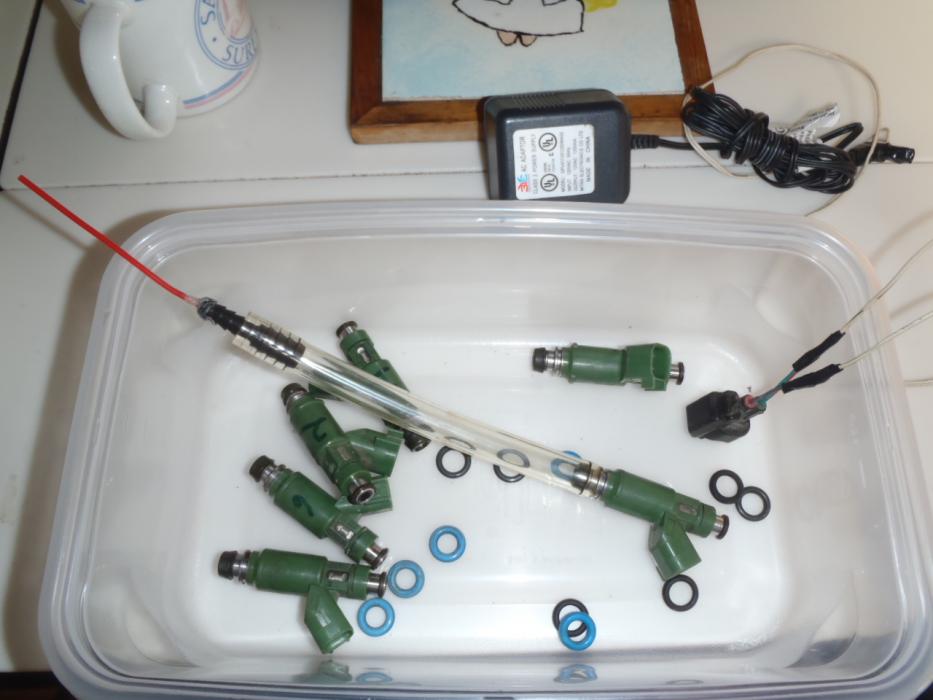

i made an injector cleaner and cleaned the injectors. the motor oil was used on the o-rings prior to assembly.
