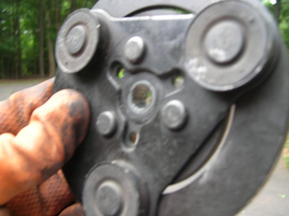

As shown in pics below, I used a 13mm socket and a screw driver to remove the "little nut". It was tight but after a couple of attempts the nut came off, an extra set of hands would have helped. The screw driver held the clutch assembly from spinning.
Once the nut was removed I used another screw driver to pry the clutch spring (cover) off the clutch assembly. NOTE: DO NOT DO THIS! Use hardwood or plastic wedges, the tip of the screw driver damaged the metal clutch pad underneath the spring cover.The spring cover is splinned as shown and it is on there pretty tight.
Under the spring cover is the sealed bearing and retainer "C" clip. There is no way of lubbing that bearing!
Hope this helps.

Wow, thank you so much Joycesjag. Thant answers a few questions. I was thinking there was bearings under that that were somehow getting lubed when I sprayed. So there is no way to lube the oil, and the noise coming from there is not the bearings I'm thinking now. It is probably the clutch plate itself barely touching the flywheel(not sure if that's what it's called). When I spray oil it gets between those parts and the sqeaking stops temporarily. Now my question is, how do I fix that? Could I put a different clutch plate on to correct it? It's probably not a common problem.

I think you need to purchase a new or reman compressor. There are 2 different casing styles be sure to get the right one.

Simply put it is not a slide off. A press will get the entire clutch assembly off. Again I must stress to remove the clutch assembly from the compressor some speciality tools or some creative thinking will work.
You need a new compressor.
