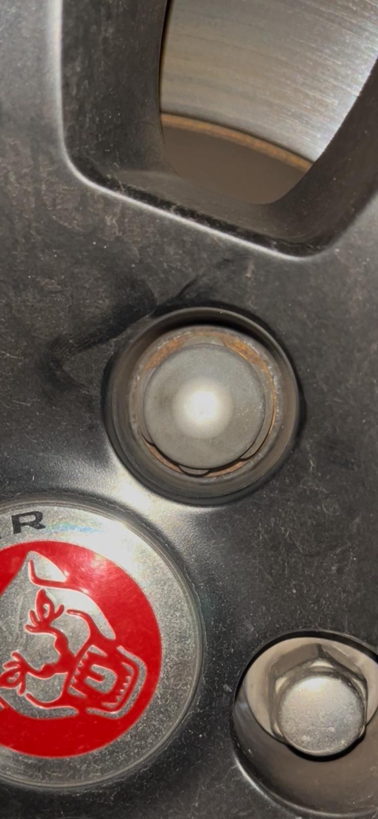

Do you have any idea what code could this be? Thanks!

Good first picture Omar. It will help you to get better definition on where the tops of the left and right hand lugs/ears start as they are the least well lit and you will need to know which is bigger! If you do another to show this I will point you in the right direction but please be aware that some keys are very similar an, on occasion, it is only possible to narrow down the options to two or three of the 20 keys. This is not the end of the world as, even if you have to buy a couple they are easily resaleable and, almost noone ever replaces their lockers so can sell all of those they buy. Hope this helps, Mike.
Thanks Mike, really appreciated. Here you go with a new photo, hope this helps.

Much better picture Omar. i am just about to message you with next steps.
Good luck. Mike.
