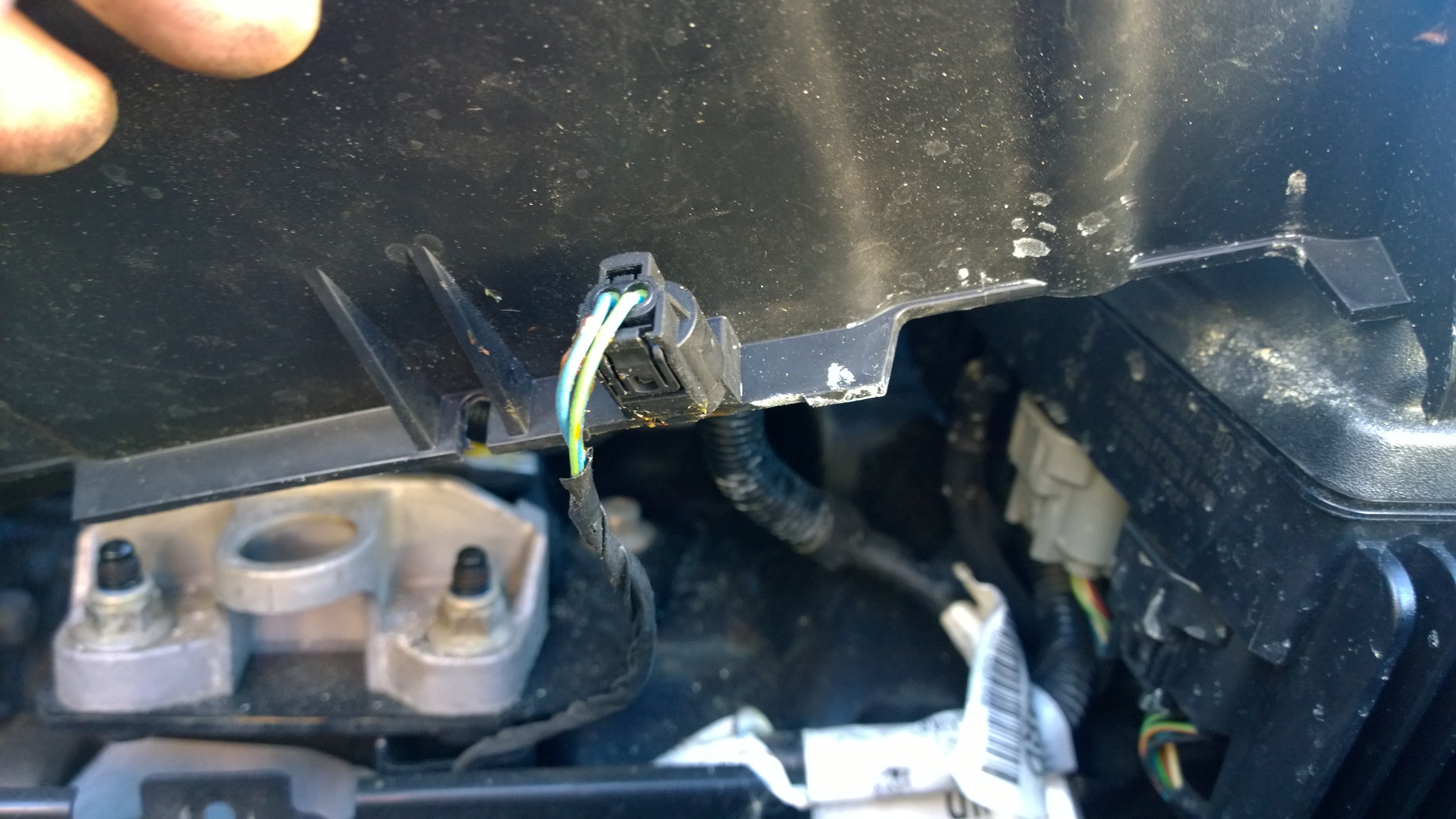

So I took out the battery and all the cables look fine. I did notice a connector that was attached to the base of the battery box but its not connected to anything. Can anyone tell me what it does?
https://www.jaguarforums.com/forum/a...1&d=1447270454
I did find a loose connector, it looks like the tab that snaps it in is broken. I seems to connect fine but I don't know what it does or if it impacts the car in anyway. Any suggestions would be great

The plug was for a battery maintaining relay that was used to ship the vehicle and then removed by the dealer and returned to the factory. it has no effect on anything now and the battery box mount is just a holding spot to keep the wires from being damaged.

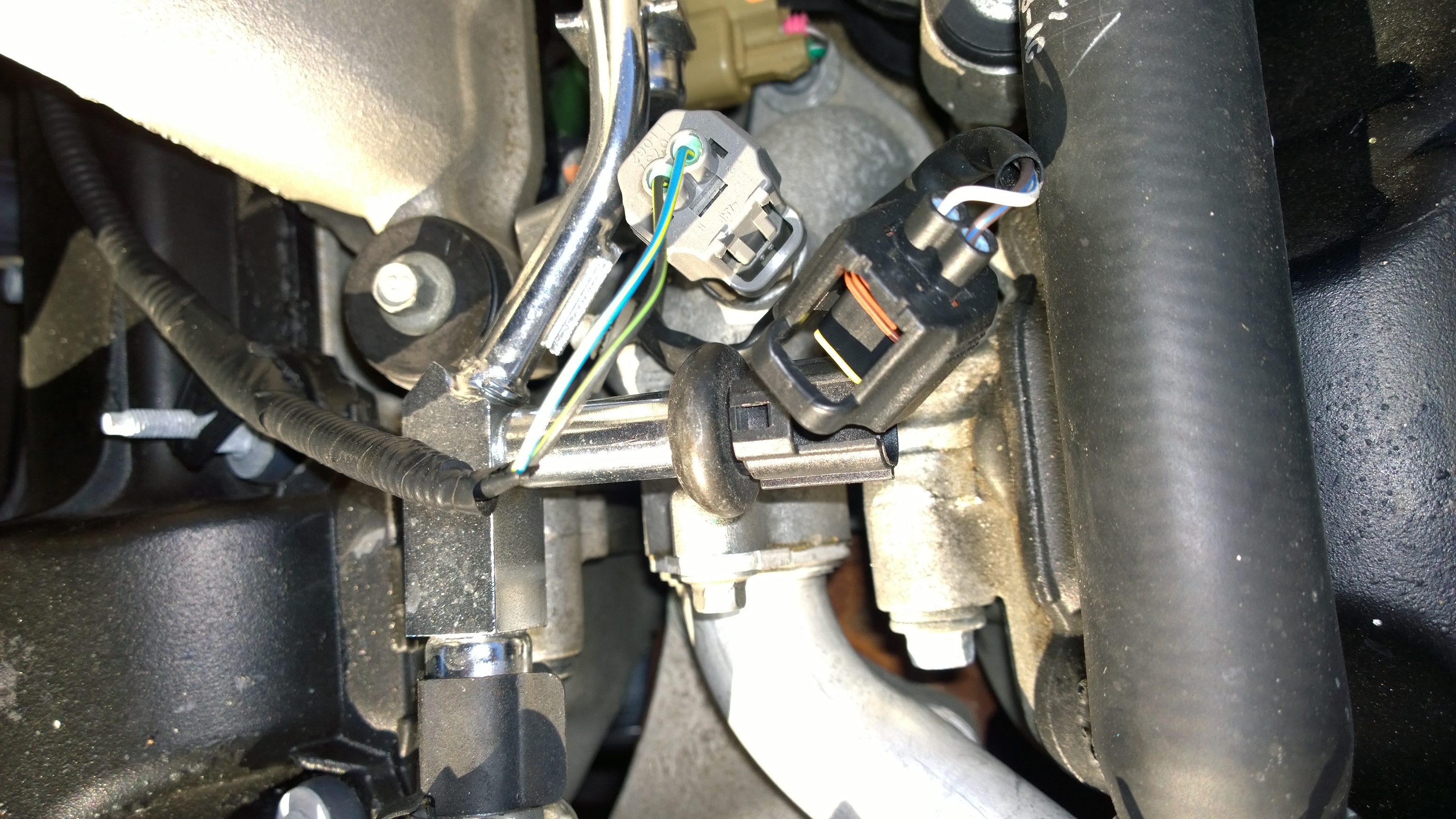

Thanks, do you know what the connector in the second picture does? I have just put everything back together and now the car runs really rough and the check engine light is still on.

drossy, both of those codes deal with the fuel rail. P0182 is a low fuel rail temp, P0191 is a low fuel rail pressure. the low fuel pressure can be simply that the fuel rail got unplugged. This sensor is on the passenger side as I recall. The fuel rail temp sensor is probably in the same area. You can also chase the wiring to where the two sensors join wiring wise and then follow that towards the battery/brake booster. You may find that a connector got unplugged and that will fix your issue.

drossy, I don't have any pictures. But, if you remove the plastic over the top of the engine, you should see the bright silver tubes under the intake that are connected to the fuel injectors. If you look over towards the passenger tire (US car) on the fuel rail, you will see where the fuel rail comes in. You will see some electrical connectors on this rail. One will be the fuel temp sensor, the other will be the fuel pressure sensor (the pressure one may have a vacuum line running to it too, don't recall off the top of my head).

I did find the sensor and everything looked fine. I am taking it to a jaguar service place this morning to see what's the problem and see how much it will cost to get fixed.
