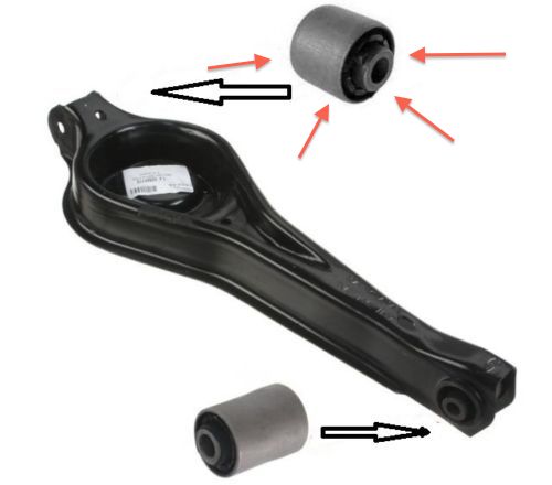

I need assistance with finding the name or part number for this bushing in the photo. i need the one with the red arrows pointing at it.. and it anyone knows where to get it that would be amazing!!

Now, I can not say that these will be an exact fit, but look at the bushings for either the S-Type or for the Volvo S40/Mazda 3/Ford Focus SV. I am sure with some measuring, you can find a piece that will work for you. There will be 3 measurements that will be needed to make sure you get a correct part. You need to know the inner diameter (where the bolt goes through, the outer diameter, and then the length of the bushing. You get something that matches those numbers and you are good.

C2514740
for the bushing that goes to the hub (all your red arrows)
http://www.xtypeparts.com/suspension...-arm-bush.html
as for the other bushing I just got a new arm from rockauto.
easy to do.
https://www.jaguarforums.com/forum/x...shings-121294/

Thank you!! its sounds like a squeaky bed for every bump and crack in the road.. i can't wait to fix it!
