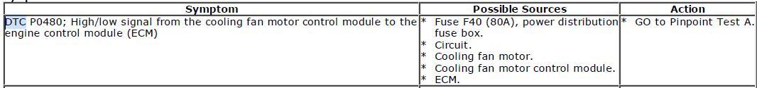

Below are the definitions from the tech manual. Note they are P codes as MOTORCARMAN stated sometimes P codes show up as B codes.
Currenty you are running in "restricted performance" mode. That's why the yellow light and rpm limitation. Either the fan control module, coolant temperature sensor or the ECM are operating with wrong data and restricted performance is minimizing engine damage.
The first step is to delete the codes and then drive a few cycles until check engine light returns. It is the only way to tell what codes are current and what codes were prior resolved problems.
The fan control modules are a known problem with failure.
Delete , drive and recheck codes. Then post them so we can help further.
