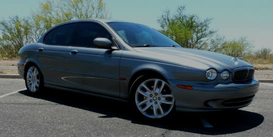

Quoting Thermo: "As for the mileage that you can expect out of the car, you can easily get 300K miles out of the car as long as you maintain it. Ignore it or abuse it and it will be very expensive to get it out to even 200K miles."
That's really good news. I just hit 100K and my Jag is doing great.
