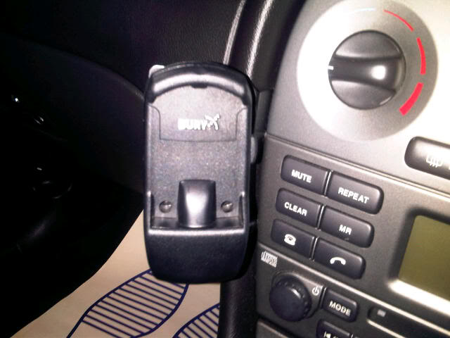

Cheers for that lads. More info for you. There is an aerial sucker on the windscreen under my tax disc, dont know if that is linked to it ??
Therm i tried your advice and the screen say No Phone.
Here are 2 pics of what i have
Old Aug 12, 2012 | 09:41 AM
You have:
1. an aftermarket phone installation
2. a very nice wicker basket
The Bury may have been interfaced with the Jaguar system to some extent (I used an aftermarket Parrot Bluetooth in an earlier Jaguar and it mapped to everything but the steering wheel controls).
Follow Thermo's procedure in post #4 to see if it is connected to the vehicle or totally independent.

Looks like it's linked to the vehicle system. Do you have the Bury Handbook or is there a Model Number on the pod?
Bury documentation can be downloaded from here:
Download centre
Once you can identify the model, it should be easy to find compatible handsets and the pairing procedure.
Old Aug 12, 2012 | 02:37 PM
Yorkiemark's Avatar
Joined: Aug 2012
Posts: 29
From: Rotherham
Hi Graham, i have sorted it. I have been on the Bury website. I have the Bury 8 uni take and talk system. They retail for approx 75 quid, you have that fitted then you buy a cradle to suit the phone you have. All cradles for a type 8 system fit my mounting. I am currently ebay bidding on a cradle for my phone. The website say i have to bluetooth my phone to the cradle before trying to use it, so watch this space. The one i am bidding on is as new in the box with instructions, so should be ok.
