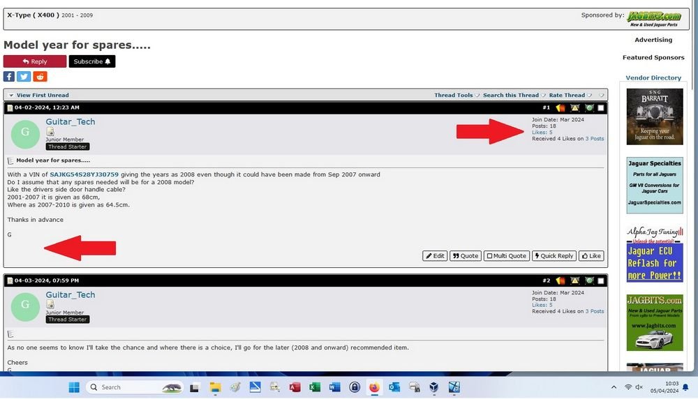

I read a lot of posts and therefore cannot remember every member's Location or Vehicle details. It doesn't help when these don't appear in your profile so I've added them for you.
Never assume with a Jaguar - it will bite you.

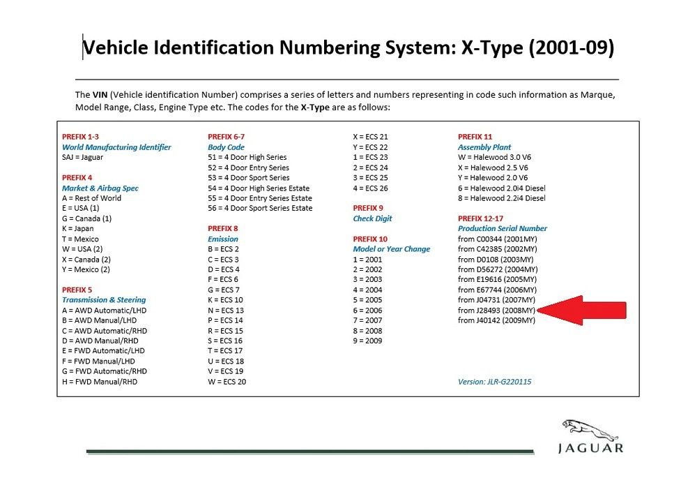

Looking up your VIN in the decode confirms the vehicle is a 2008 Model Year:
The new Model Year is usually introduced around September which is why a 2008MY can actually have been built and sold in 2007.

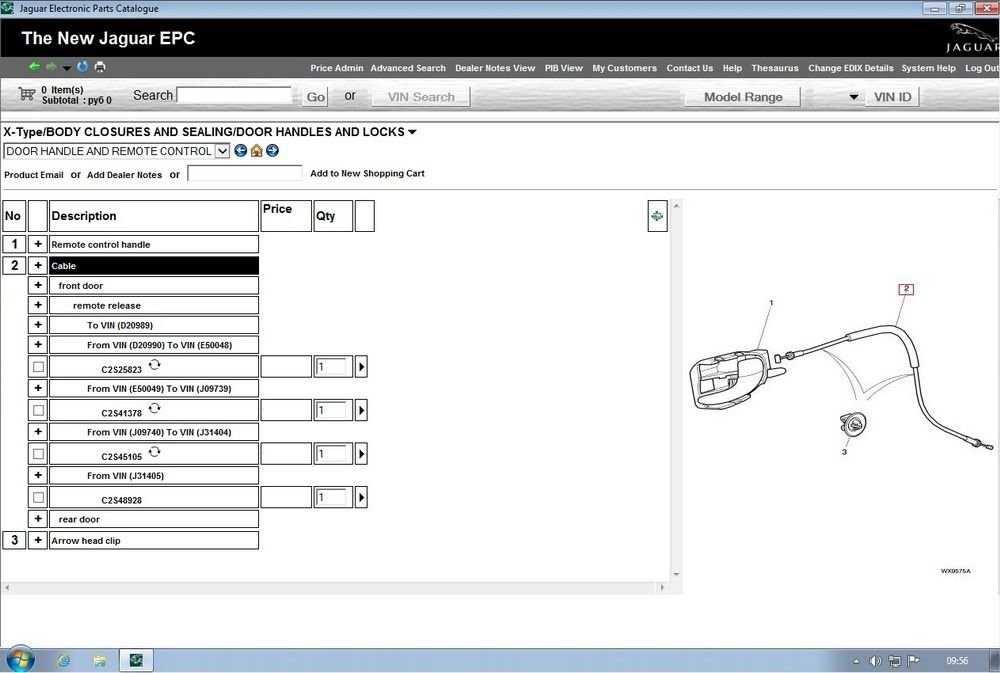

This extract from JEPC (Jaguar Electronic Parts Catalogue) shows the VIN ranges for cable updates:
The rotating arrows indicate a part number is superseded so C2S48928 will fit all years.
I suspect the reason for difference in cable lengths is the original was found to be too short and therefore binding or not allowing the interior handle to return fully to the closed position.

Many thanks for that, much appreciated.
I've expanded the Sig so there's (hopefully) no confusion.
G
