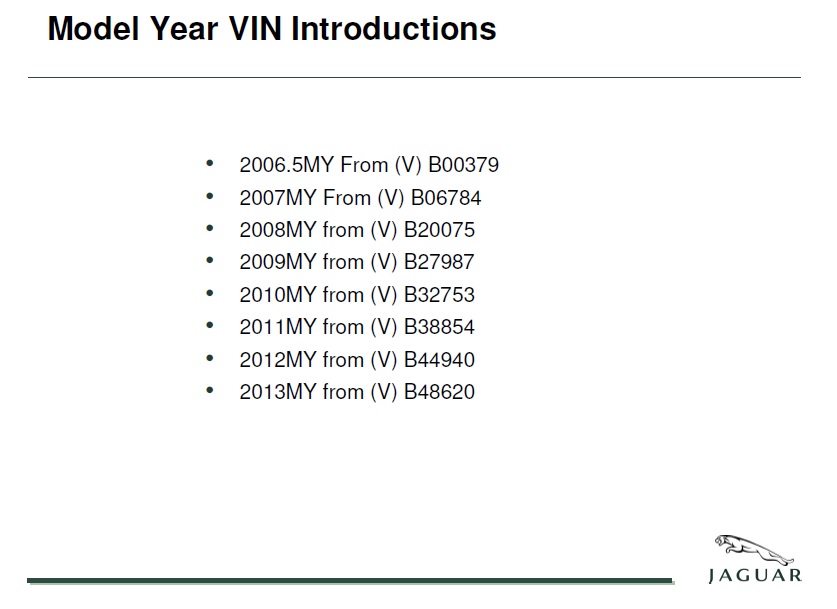

Here is the Jaguar list of Model Year VIN introductions for the XK/XKR:
For the factory, a new Model Year is the stage at which design updates are introduced primarily to encourage sales. This is not the same as Calendar Year nor necessarily what different country vehicle registration authorities may apply as 'model year' in the vehicle documentation.
