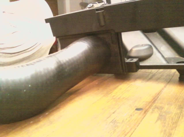

Hey MeeMo, cool thread you started. I was noticing your high flow air filter under the hood, the cone shape looks like it pulls in a lot of air. Have you seen performance gains from this? ...........It looks like it's pulling hot air from the engine compartment.
I modified my air box recently and added a third cold air pick up. I have noticed a little more pull when I accelerate, low rpms, hi rpms, pretty much across the board. Seems like the engine was a little starved for air before, notwithstanding the two stock cold air tubes. notwithstanding ????
Here is a pic of the bottom half of the air box with my tube added.Name:  1024102139.jpg
Below you can see the new hose at the left. Inside diameter = 2" or 5cm.
Total cost: $20 + your time. I did this one at my desk at home with a hole saw bit, a drill, and a tube of clear silicon adhesive. Of course I also had to find the right piece of hose, I think it a radiator hose for a bigger engine.
I took care to seal the air box with the silicon so it would not pull in hot air from the engine compartment. Anyway, my engine is a little more assertive...Dig IT!
