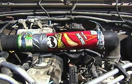

When you find the leak, a wad of chewing gum or duct tape will probably suffice to fix it until you get the new needed part. Down and dirty, cheap and easy.
All those codes kind of send a chill up your spine, don't they?
One that stops right at the bottom of your wallet.
Just clear the codes. The Check Engine Light will turn off, and you'll be fine until the engine swallows a little too much air again from the vacuum leak and pops back into Limp Mode.
Scary as it probably seems, your problem is not a problem, but more just an inexpensive inconvenience. Duct Tape and Gum can last thousands of miles, too - once you find the leak!
(Ain't that just a beautiful repair job?)
Attached Thumbnails Multiple Codes read from the 'puter-duct-tape-car-engine-repair.jpg
