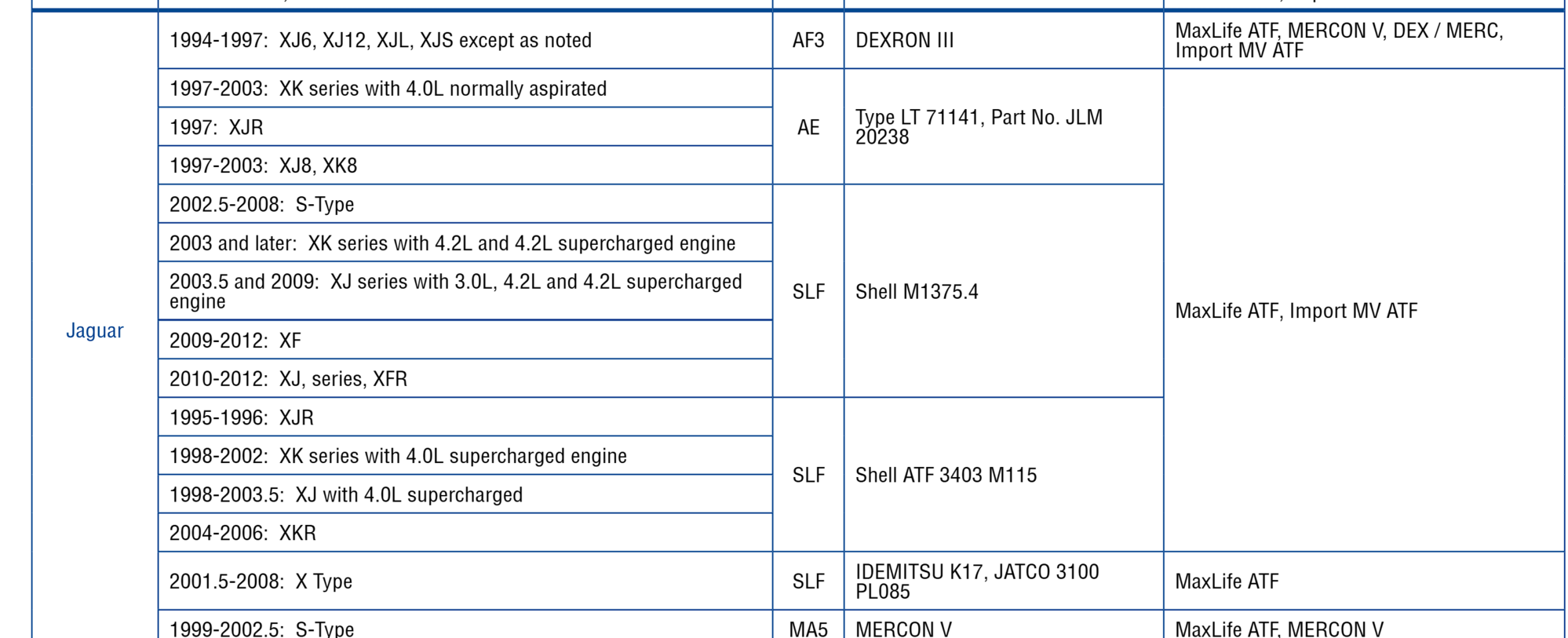

Check the specs on your chosen ATF fluid. It MUST MEET IDEMITSU K17, period.

Recommended fluids Esso LT 71141 Shell ATF 3403 M115 Shell M1375.4 MERCON V
XT-5-QM ATF IDEMITSU K17(Jatco 3100 PL085)
Model Service Fill Specification Esso LT 71141 Shell ATF 3403 M115 Shell M1375.4
MERCON V XT-5-QM ATF IDEMITSU K17(Jatco 3100 PL085)

Valvoline Application Guide showns Maxkife ATF
