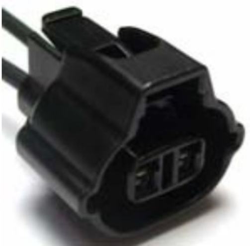

Matthew: The TPS electrical connector is Motorcraft part # WPT-1269.
You can buy one for $11 + $6 shipping via priority mail from here: [WPT-1269]Motorcraft/Ford Wire Assembly(WPT-1269)
Connector WPT-1269 is on page 12 of Ford's electrical connector catalog: http://www.fordservicecontent.com/pu...torcatalog.pdf
It's a common problem for this connector to become brittle from engine heat & age.
Good luck.
Last edited by dwclapp; Jan 5, 2016 at 11:05 AM. Reason: fixed link to Ford's electrical connector catalog

Thank you! I ordered the part and will put it in as soon as I get it. I will post a follow up after I get it done.
Thanks again!
